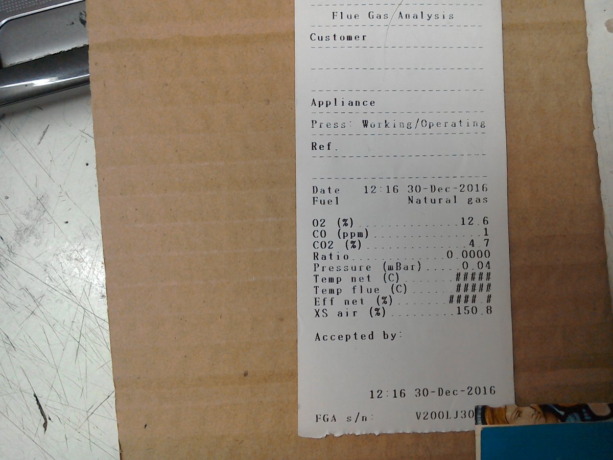

just out of curiosity, did they perform the flue analysis and did they give you a little print out or told you if all the readings were Ok and within the required limits? what was your CO reading? this is just out of interest as I had mine serviced yesterday and the RGE gave me a print out of mine which said the following :
O2 %: 12.6
CO (PPM) 1
CO2 % 4.7
Ratio: 0.0000
pressure mbars 0.04
put it this way 0.0000 my ass , as your ratio would more like 0.02 , is that your high rate results ,not as healthy as you thought . steel has the nose for bullsh!tters :)

yes that is a true reading as far as his printer can print to 4 decimal points., not sure myself if I should believe those results, if assuming Co is only 1PPM, then I should be able to bring back the flue gasses and heat my house with 100% efficiency, now what do you recon? do you think it is a terrific idea? :cool:(y)
BTW, oxygen would be ok too, as there will 12.6% oxygen in the flue gasses, so wow, Happy New Year!

On the serious note yes that is the figure printed exactly as it is, RGE said that even 1ppm was going down to zero, and is on full heat, boiler was giving me explosive ignition, so i booked him to have a look what was wrong, he found that my burner pressure had crept up to almost 10mbars from the reccomended for my boiler (Vaillant 221GB) of 6mbars. he re-adjusted that and carried out low gas pressure test on low flame, he had to disconnect a certain rubber tubing from air pump and did then he set the low gas burner pressure. Having said that he checked incoming gas pressure as well, with my cooker all 4 burners on full heat and said the incoming pressure was within the limits.
#Boiler works real good now, no more explosive ignition, very silent, and btw its been ON 24/7 since October this year, on a cycling ON/OFF and no room thermostat as I run it at very low flow temperature of 40C. Original install date April 1994.
