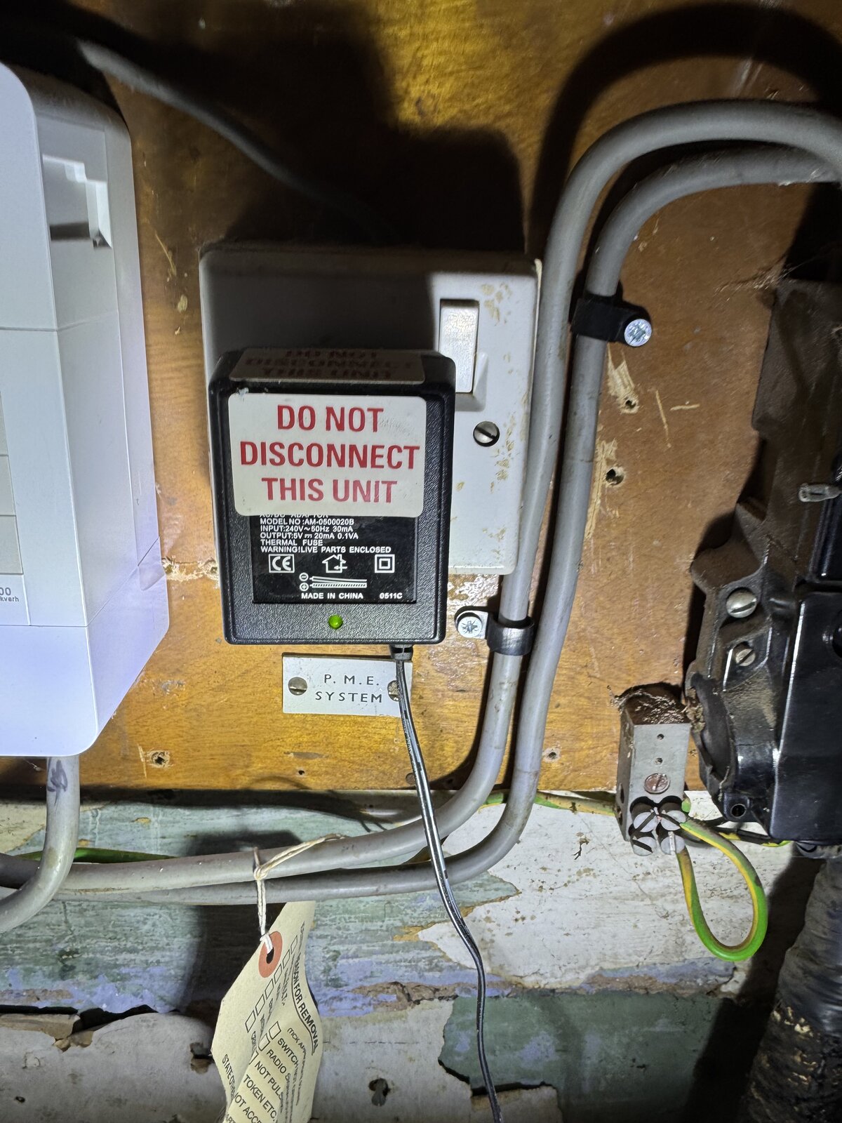

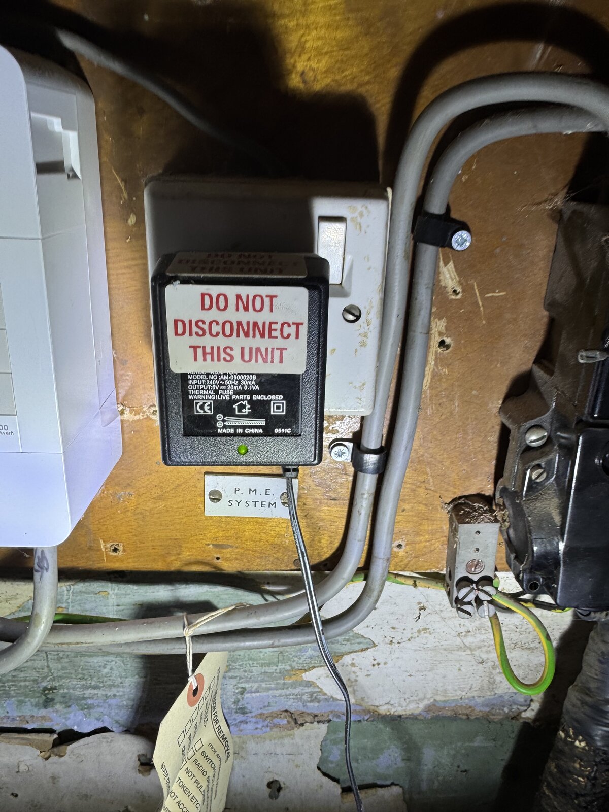

I recently purchased a house and it has a strange plug next to the fuse box that I can’t figure out what it’s for. I have attached some images the plug
Outdoor lights, ring type doorbell? Could be powering anything, turn it off and see what stops working.
What does it say on the label on top of the plug in power supply?
The sticker on the top is the same as the one in the front.

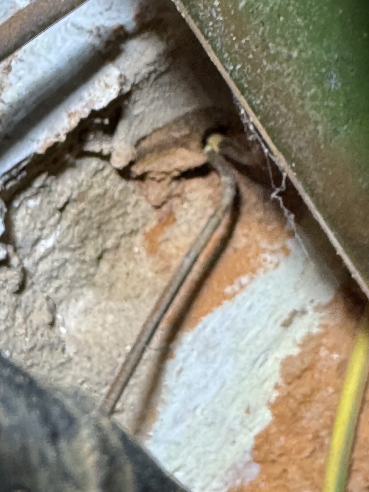

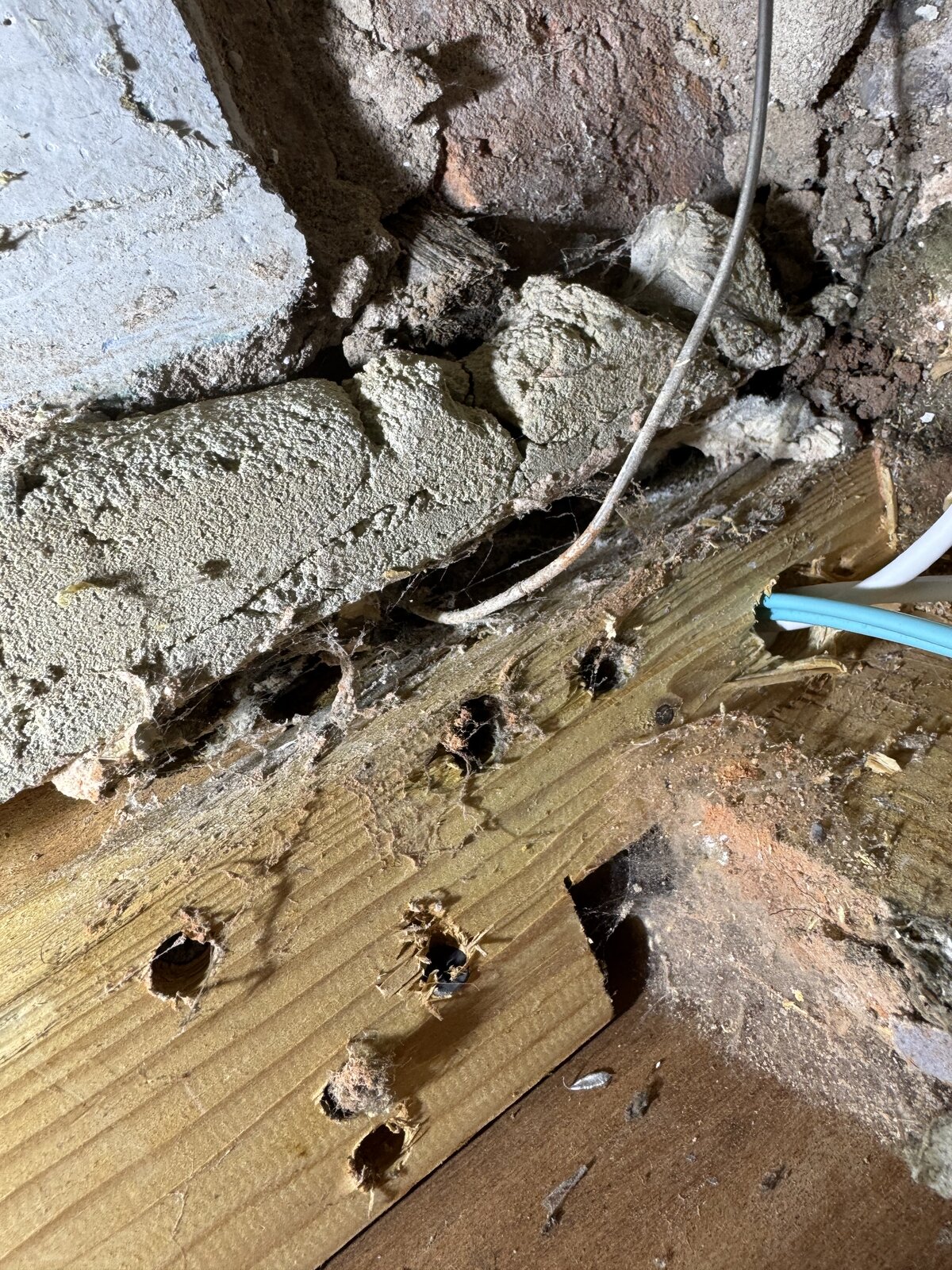

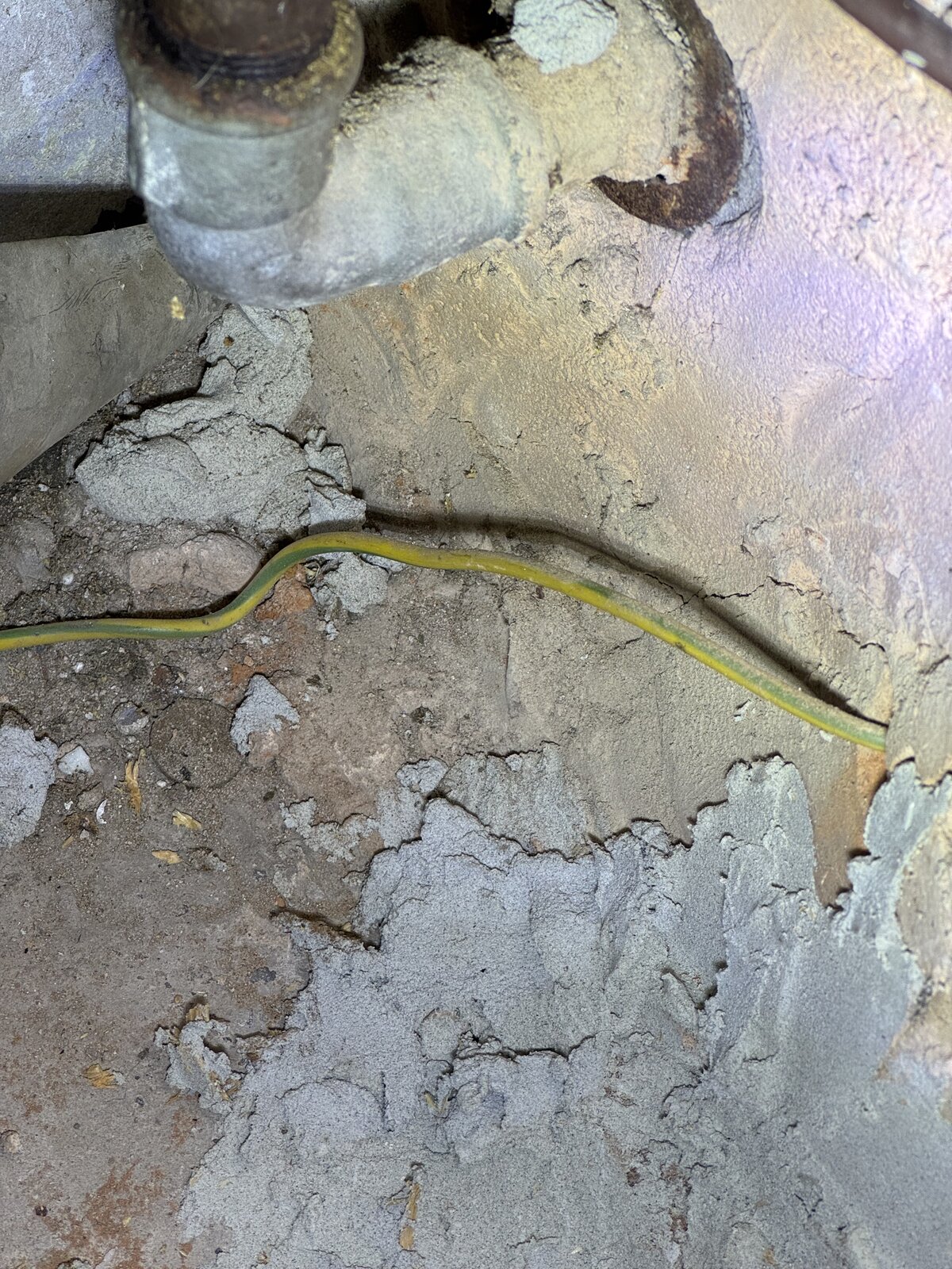

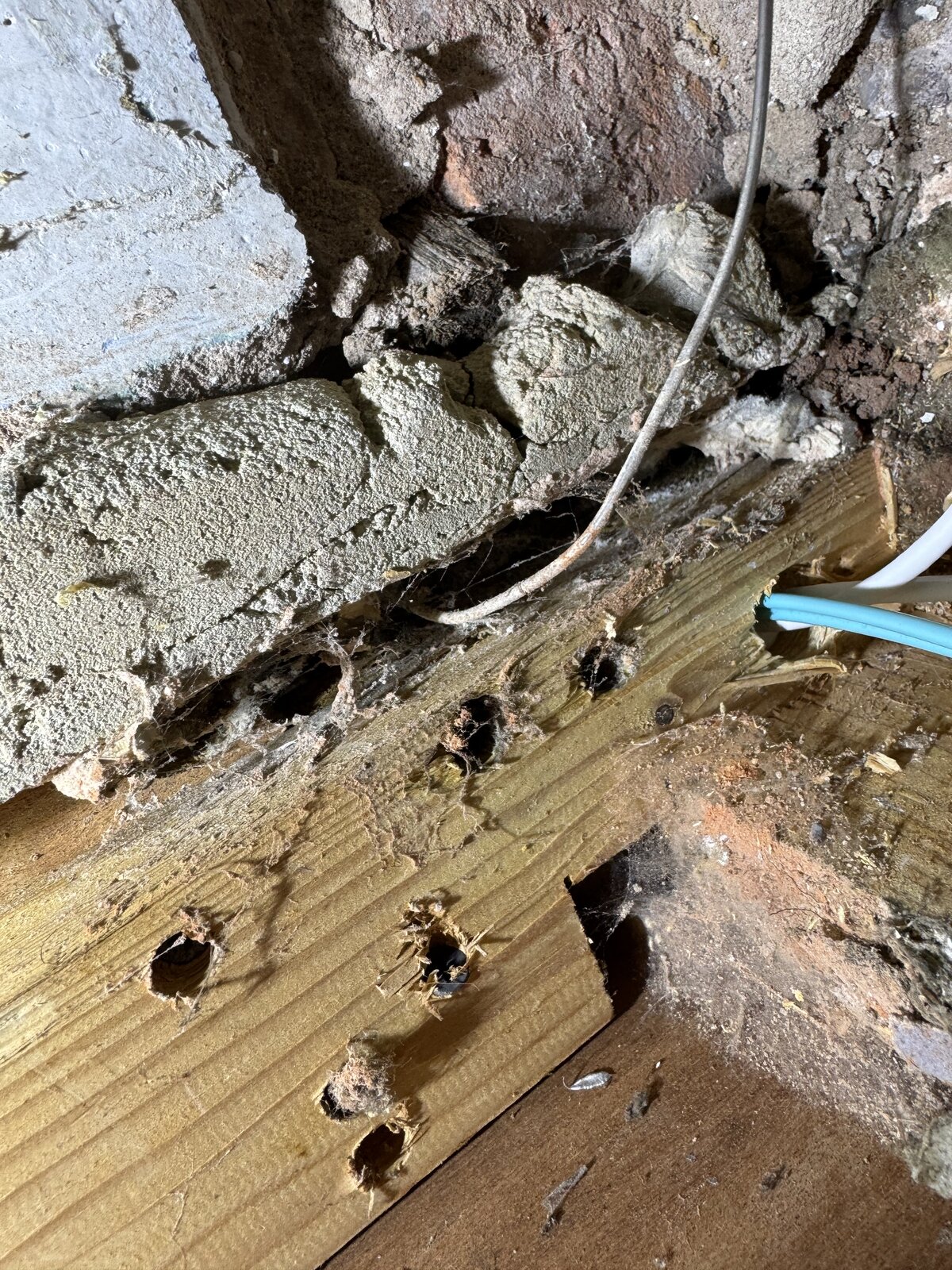

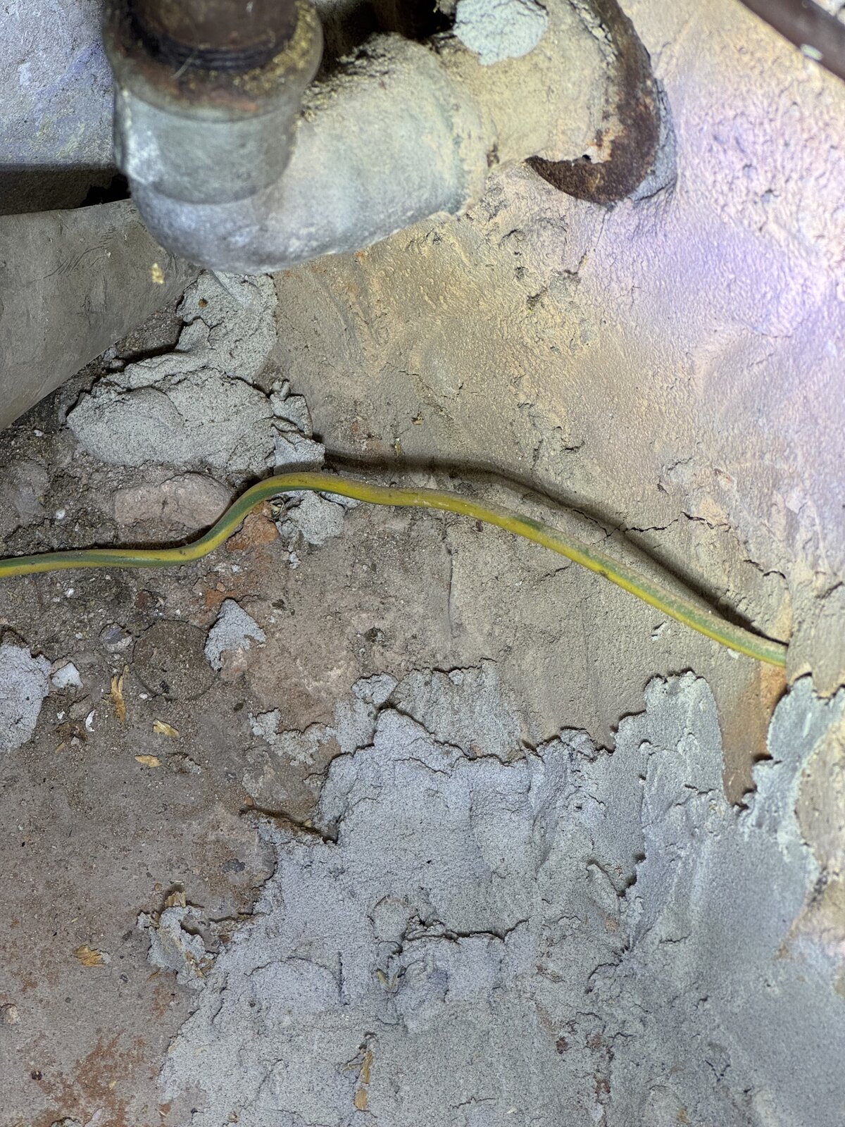

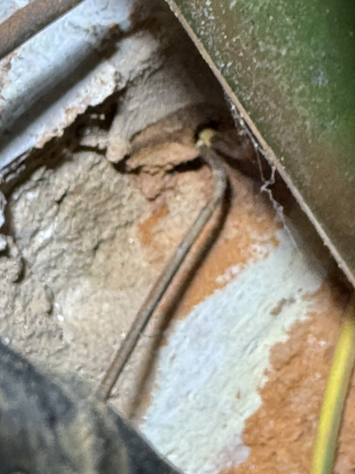

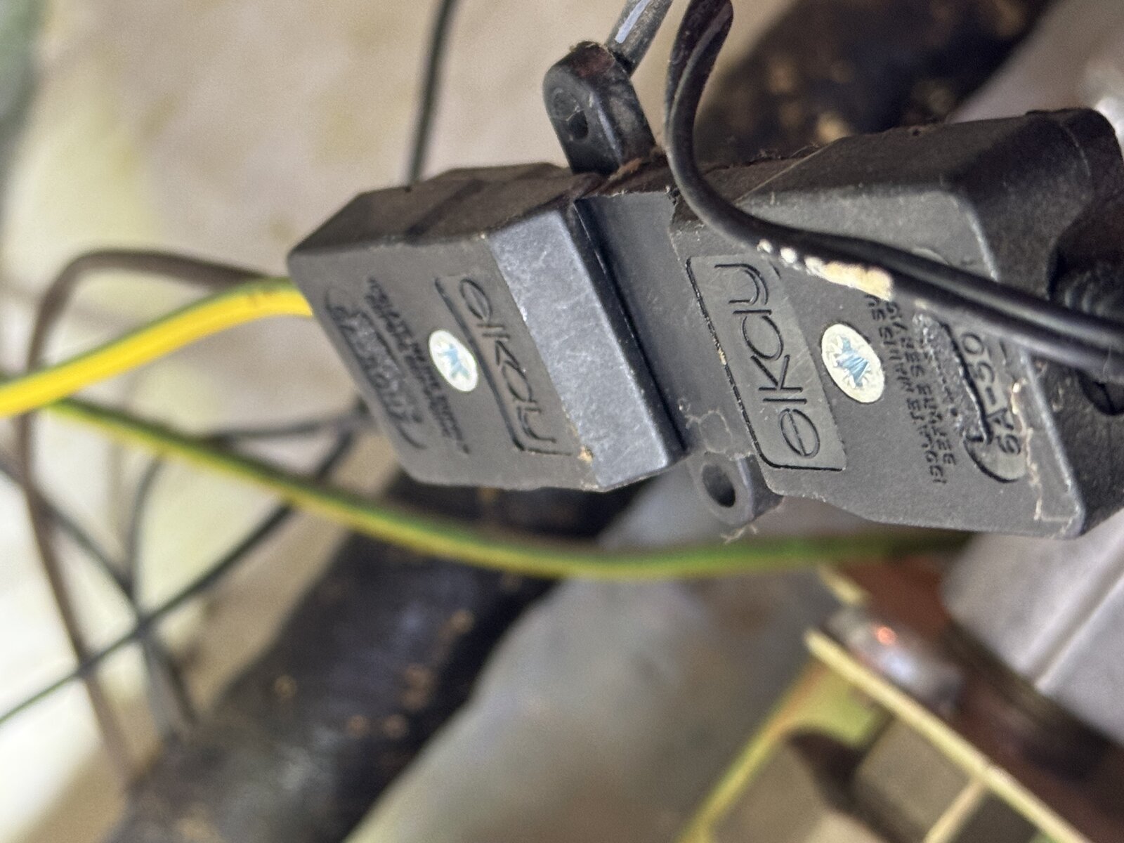

I don’t have a door bell or outside lights and the two cables that come out of the other side connector the earth coloured cable goes to right side of the cupboard and into the wall and the brown cable goes in the wall at the back of the cupboard and then comes back out as solid wire without insulation and goes to the left side of the cupboard but from there I can not find any trace of it.

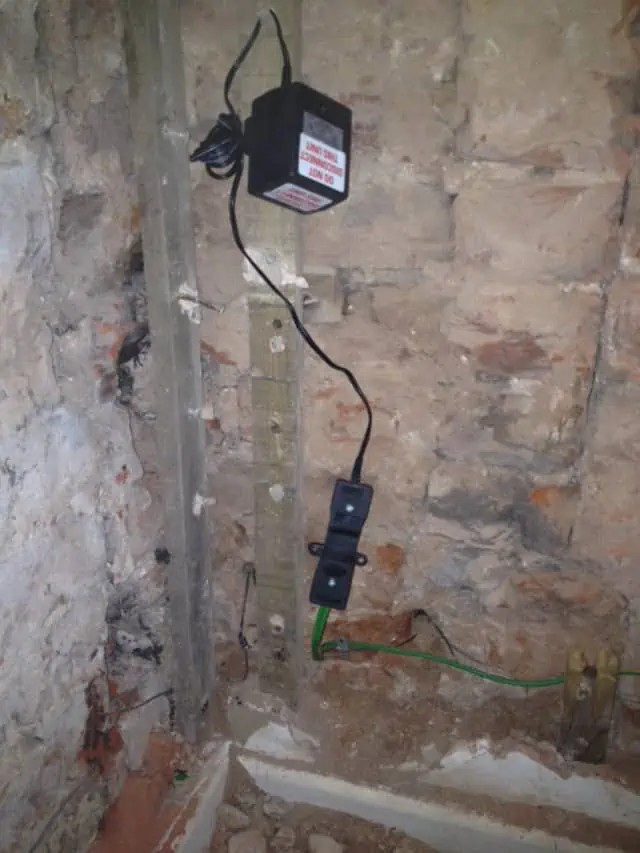

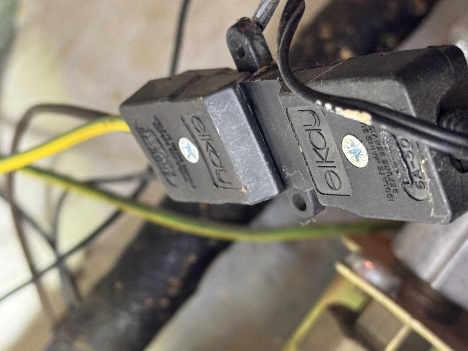

It looks a lot like this...
"Electro osmotic damp proofing" apparently!
Yea that seem to be it. The report mentioned an old chemical DPC but nothing about this system. I am wondering if I should just unplug it or leave it be.
As it consumes the square root of b*gger all power wise I would just leave it switched on. Of course we are also assuming the wall wart still puts out a voltage
It really ought to have a label saying what it does.
If you know, add one.
Hah . Electro osmosis damp
Proof system! Was fairly popular back in my early days as a cheap form of damp proofing and was supposed to be left permanently on and intact.
The basic idea was that electrolysis was natural in the flow of electrons in a damp wall and you reversed the polarity therefore the direction of flow to combat the damp .
Using earth for one pole of the electrode then the other electrode was a fine conductive wire buried in the wall at a higher level and the constant voltage between wall and floor caused a long slow
Migration of natural salts in the wall to travel down not up.
The voltage was very low , hence safe and the current was very low too and must be left on at all times and unbroken.
So much for the science (or pseudo-science). A lot of people were convinced that it worked and some firms made a lot of money by providing it.
Was it “snake oil”? I have no actual evidence that it was not but you know what people can be like! Convinced it must work then everything proved that it did work and all the evidence that it does not work was discounted , just like religion and politics and a host of other human beliefs.
