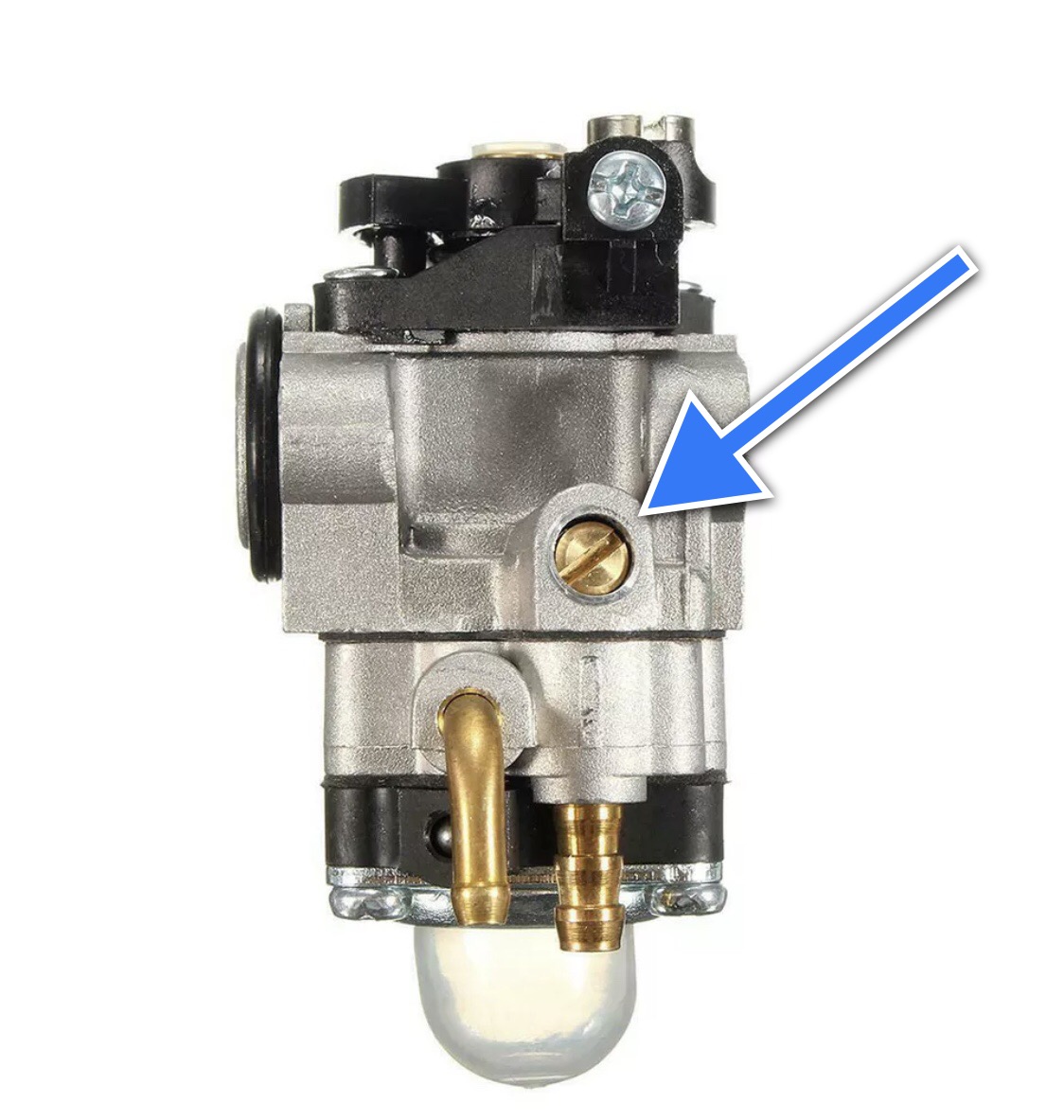

On the carb just above the inlet fuel pipe what is the name of that screw adjuster. This is the one I adjust when setting the mixture / tick over whilst holding down the throttle.

3). Pilot or slow running mixture screw.....anticlock to richen. If its the carb I’m thinking about, full throttle running is altered by a screw on the throttle operating quadrant.

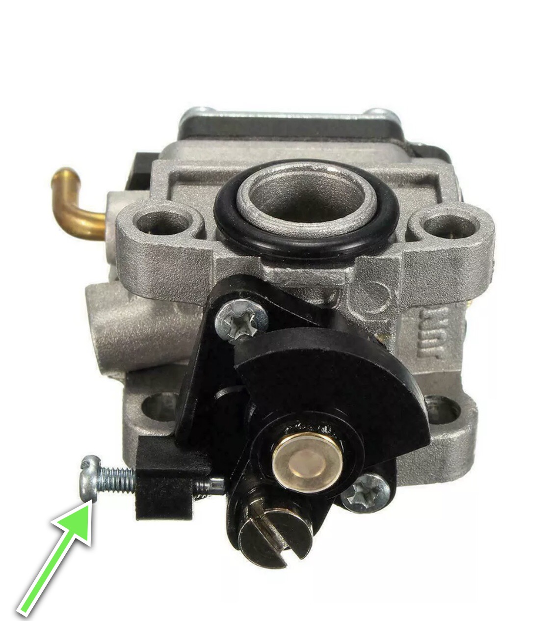

Green I adjust for Tickover.
Blue I hold down the trigger and turn clockwise & anti clockwise and find the sweet spot in between.

That'll do - effectively the blue screw is for low speed running but it does have an effect on full throttle performance. The green is the tickover adjustment screw.
As you increase throttle, notice the plastic throttle quadrant lifts up slightly.....this is lifting a needle out of a jet increasing fuel flow.
John :)
