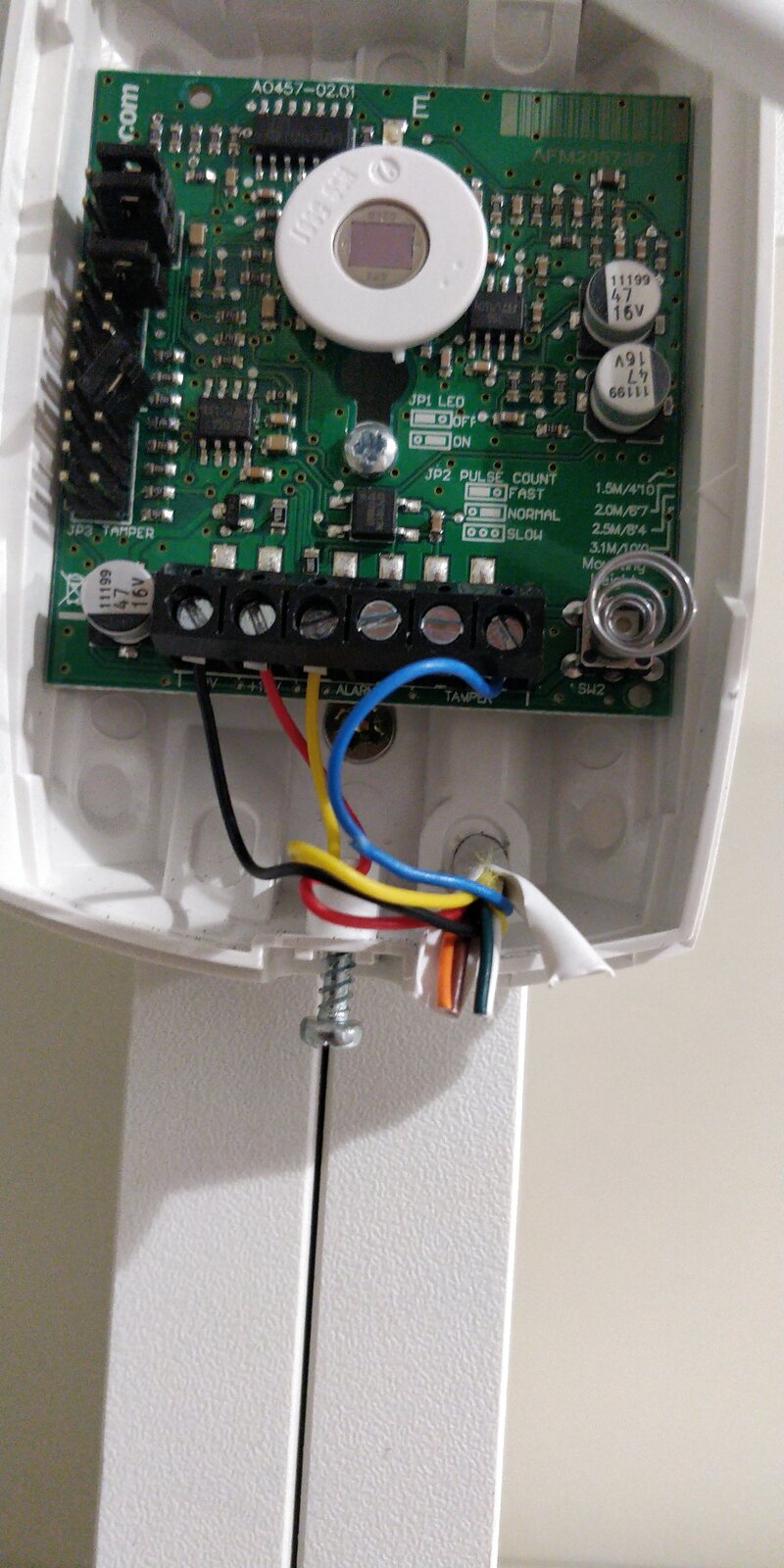

Hi Guys
Just fitted a premier elite 24 with
1x Door contact
3x Texecom Premier Compact ACD-001 PIR
1x Piezo Siren
1x Extension Speaker
Have progammed Zone 1 as NC
Zone 2/3/4 as EOL
But i am getting a tamper fault on Zone 2/3/4
I have wired it as below from the sensor
+ - alarm alarm tamper tamper
red black yellow blank blank blue
and on the control panel zone 2/3/4 - yellow / blue
Not sure where i have gone wrong, any help much appreciated.
Also for the extension speaker there is only a spk- not sure where this would get connected?
Also have wintex.
Any help much appreciated
Wiring /resistor jumper not correct.
Post photo of pir wiring with selected jumper positions, also post wiring of control panel wiring.

Thanks for the reply,
Only have a picture of the pir at the moment.
Just noticed the jumper are only on one pin would this be the issue?
Thanks guys now sorted
