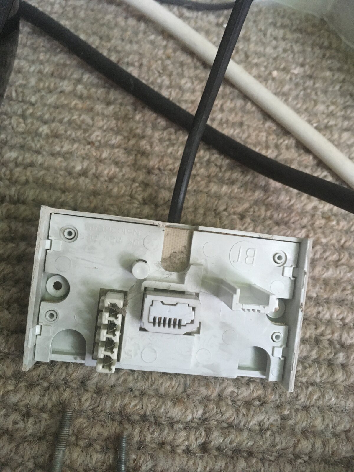

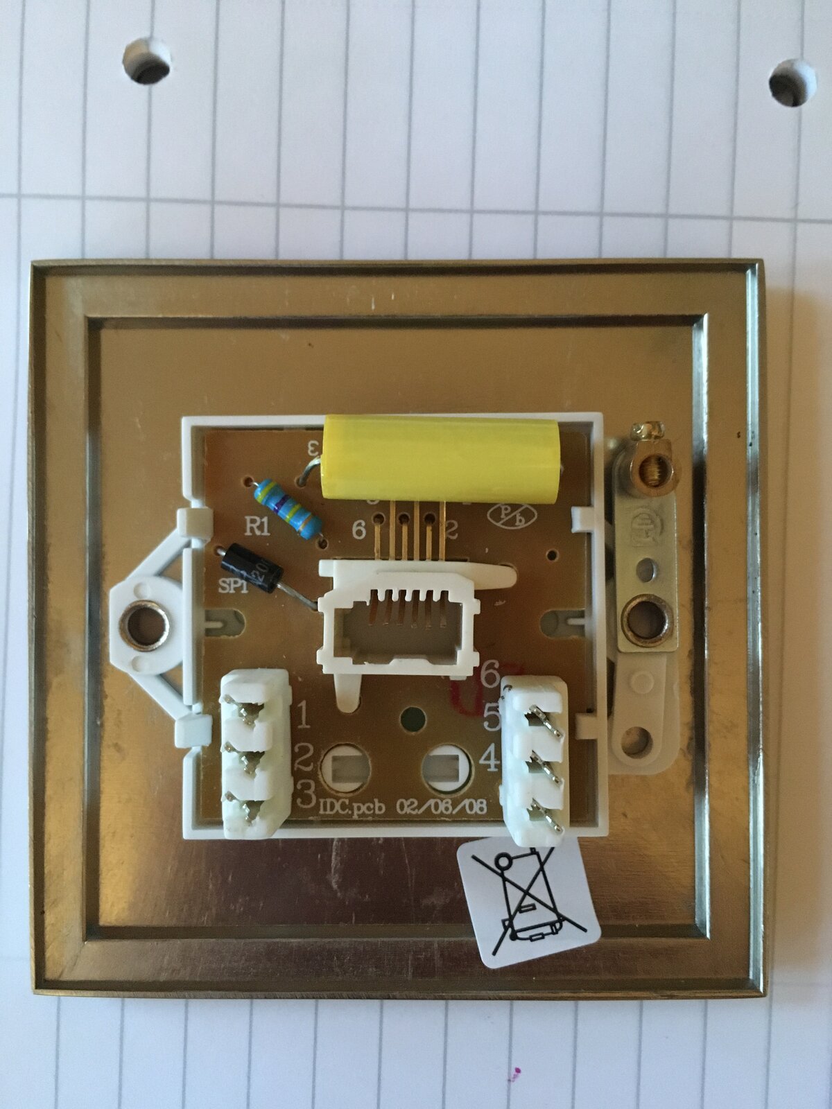

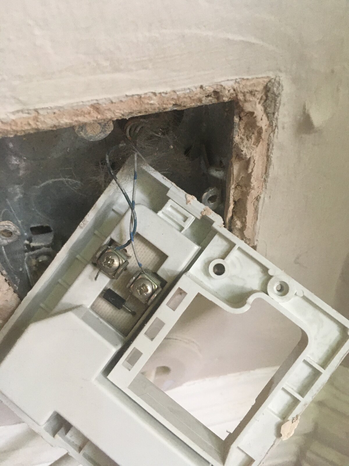

I’d like to replace the plastic cover of my telephone point with a nice metal one but I’m stuck with the wiring. Hopefully the photos do the explaining. Thanks.

The white one you've got is a NTE (network termination equipment) and is required to terminate the OpenReach line and provide a means of disconnecting your extension wiring, provide a test point to plug a telephone into, and allow the future use of service-specific faceplates for DSL filtering and voice reinjection (VRI) when the phone network is converted to VoIP in the next few years.
Simply put, it belongs to Openreach and you can't change it for a decorative one.
Well, under the terms of service you're not permitted to change it
That's not the same as can't. The metal one in your photo will work (with an external ADSL filter) but if BT/Openreach ever see it they will remove it and bin it.
4 of the previous 5 posts are correct that you are not permitted to touch your NTE (Original white socket).
Basically what you need to do is find somewhere else to put the NTE.
Are there any preceding junction boxes/joints in this cable or is it the cable coming in from the ground?
24ff68e8-9f05-47c7-9eb8-692aba02846a-jpeg.251647
The orange is the bell wire - if you have extensions.
Do phones still need the bell wire (other than retro phones)?
Why have you got two wires in 3 and 2? If you had two in 2,3 and 5 I would have assumed that you have an extension running from it but I can't see how that extension would work with only 3 and 2.
I vaguely recall being told that 4 was reserved for "future use". I never did find out what that future use was.
1. Some do. (more than people think)
2. Well its a socket in the middle of a chain. Someone has incorrectly put the wire in 4 rather than 5
3. When the R recall button is pressed, this sometimes puts a voltage on pin 4. But this is selectable on the phone usually
