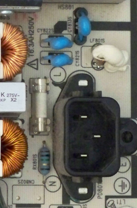

This is the main fuse in my TV. It is a few years old.
It is 6.3A
You didn't just take the back off your TV for us, did you?!
No, I remembered I had the picture from when I had to change the board. :)
Interesting - it must be intended for a lighting circuit :)
:LOL:
What is the alleged running current or power of the TV?
180W - even though it's LED.
I brought it with me and it's quite happy with the 16A RCBO.
