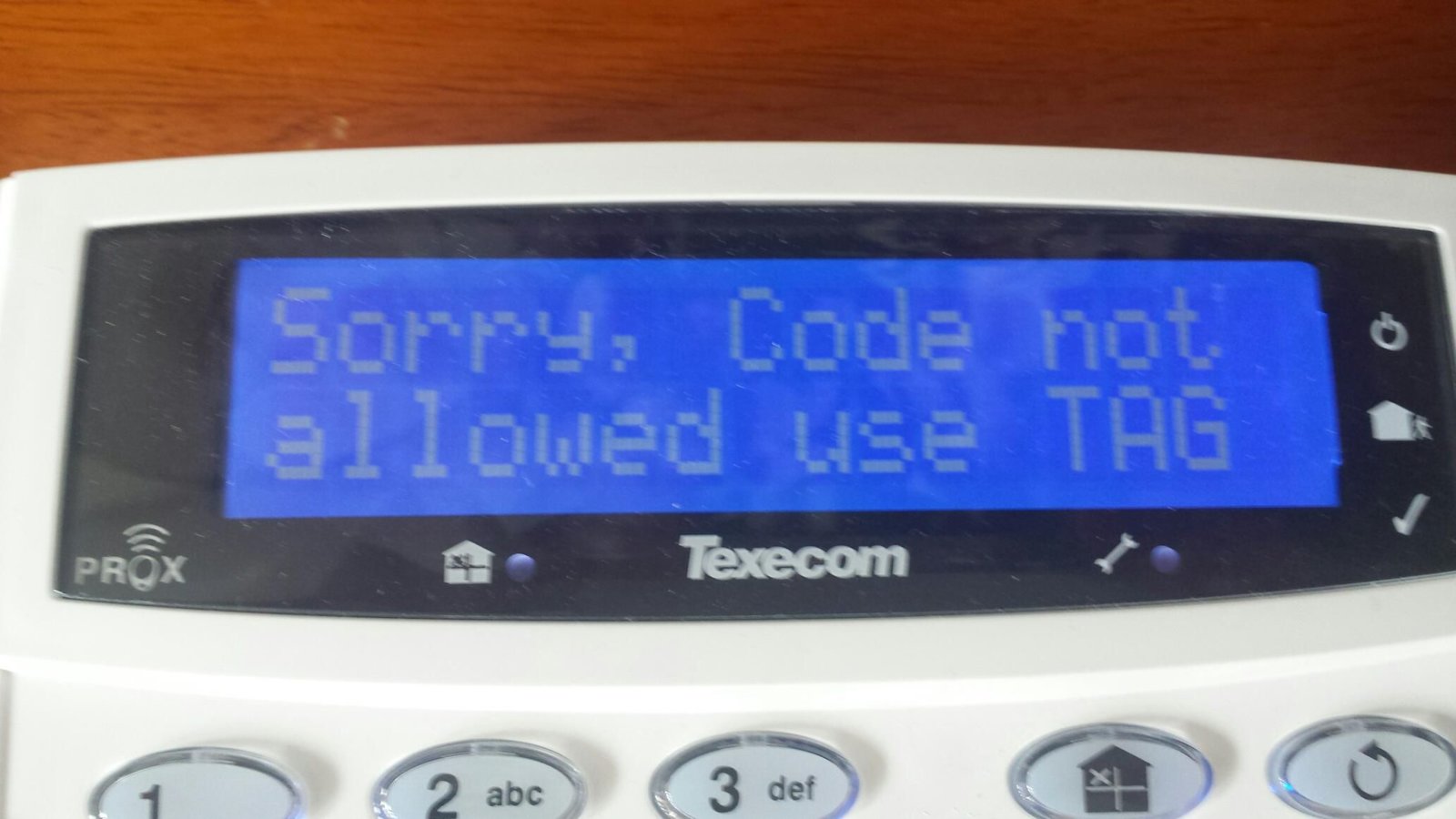

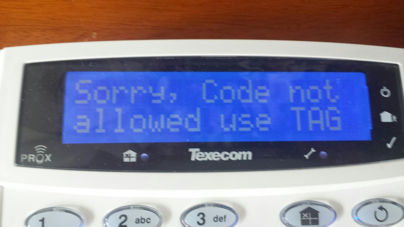

However when I arm from the Master user using the 5678 code (Not fully installed yet), leaving all works but on return I can only disarm using the SmartKey keys and not the TAG, I can't even use the user code, 5678, - it's asking me to use the TAG but again that doesn't want to work.

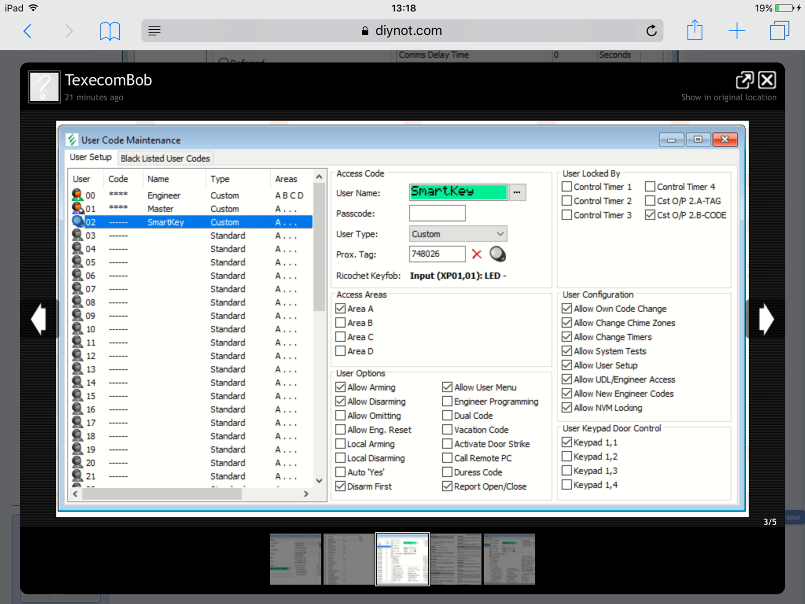

Go into wintex , look at user 1 ....is c ticked ?
This is what I get have tried Local set/unset - D - Disarming is set.. Still get the same problem..

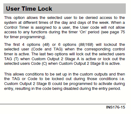

Okay.

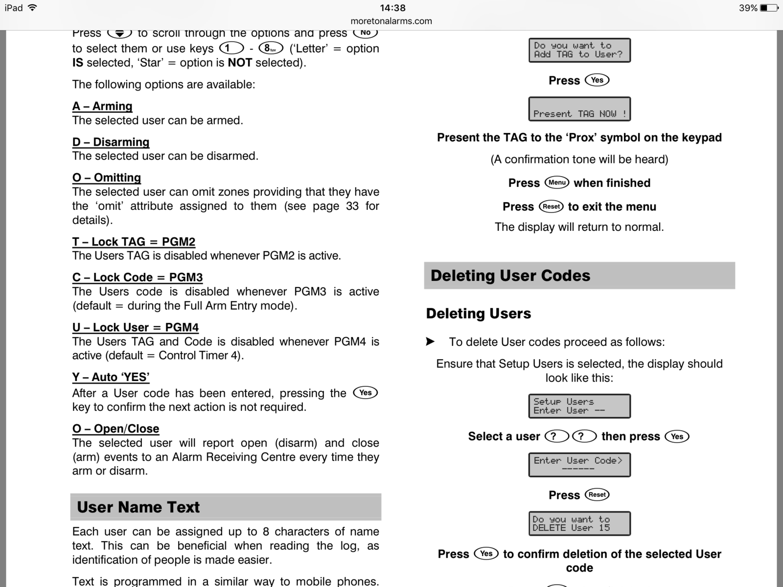

firstly your code doesn't work because user locked by C (code is turned on), its possible you also have it turned on for a TAG? and why you cant use either?
If turning those locks off still give you grief, ie cant unlock with a code, then check the code is assigned to the correct areas.
If the tag doesn't work again check the areas, but also check that the keypad can read the tag in day mode.
report back for next steps if required.

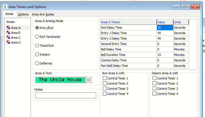

Hi Folks,
I don't seem to have a Locked C option to turn on or off.
Managed to get the TAG working, even with the Keyboard Panel livened up by an entry one still has to press the PLUS button to make the PROX work.
Please see my configuration and install info in the attached flies.

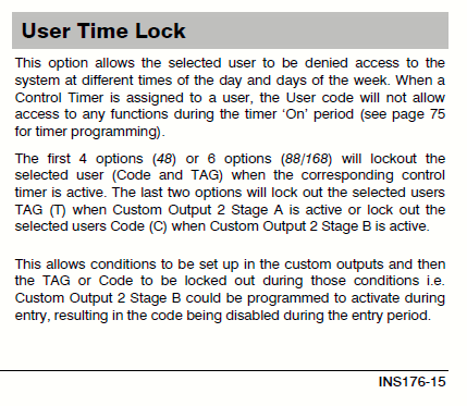

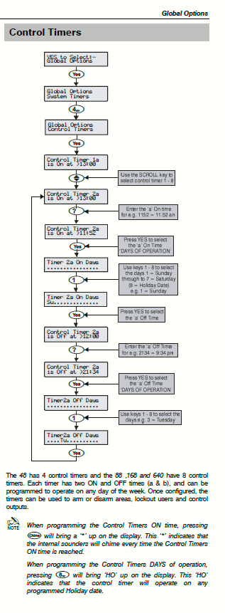

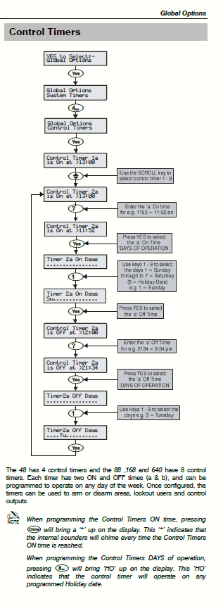

Hi Sparkymarka,
Thanks a million, I would never have found that even plowing through the Installation Manual as I did...
The only reference I could find regarding the Timers was the attached..
