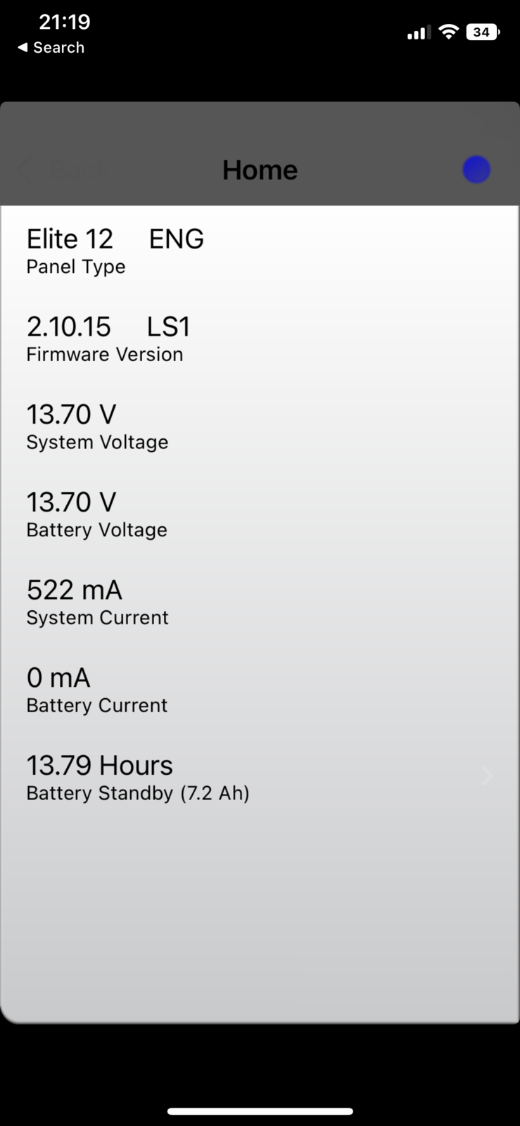

I’ll try attach a screenshot of my panel details.
I work from home pretty much all the time so as I’m here most of the time the alarm doesn’t often get set these days and it will still come up with the com 1 error. I understand what you’re saying about the com ip only doing one way comms but as I’m home most the time it might be months between opening up the app so it can’t be that causing the error surely?

The com ip polls every 15 minutes I think (would have to check the poll timer), so even when there is nothing happening with the alarm it is still regularly sending out data.
It is probably easier to flash the panel up and add a smart com.
COIM IP's still have value as they are used for coms to home automation systems and used as a dedicated channel.
