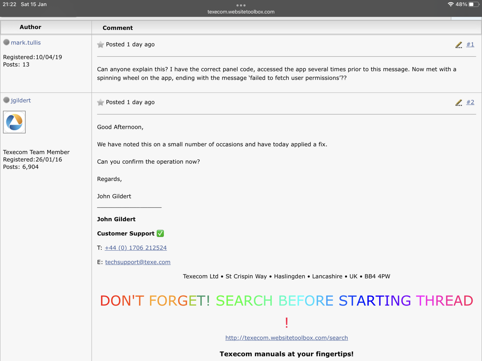

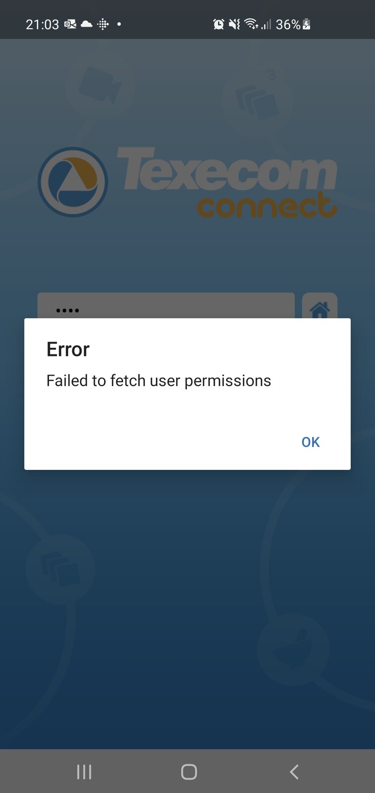

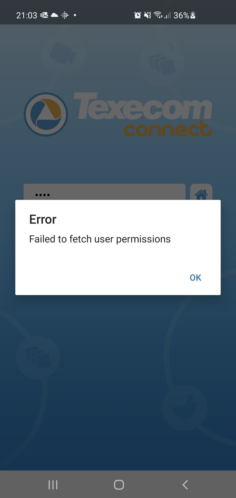

Interestingly, I tried again and just left it and after 10-15 minutes I get a vague error that I've attached.
Interesting! Sounds exactly like my issue so maybe an issue their end and maybe the panel re-sync was a red herring. Is there any more info from Texecom that you can see (they said they applied a fix but clearly not working for me)? Would it be worth me trying to register to that forum or contact Texecom or would they only accept/deal with registered installers (which I am not).
Unfortunately don't have access to the Texecom forum these days. If the fix has been applied and it still isn't working then you should contact Texecom directly for instruction/ resolution.
Non of my customers have reported issues so far, nor have the units in the office showed this issue to date. (tempting fate)
