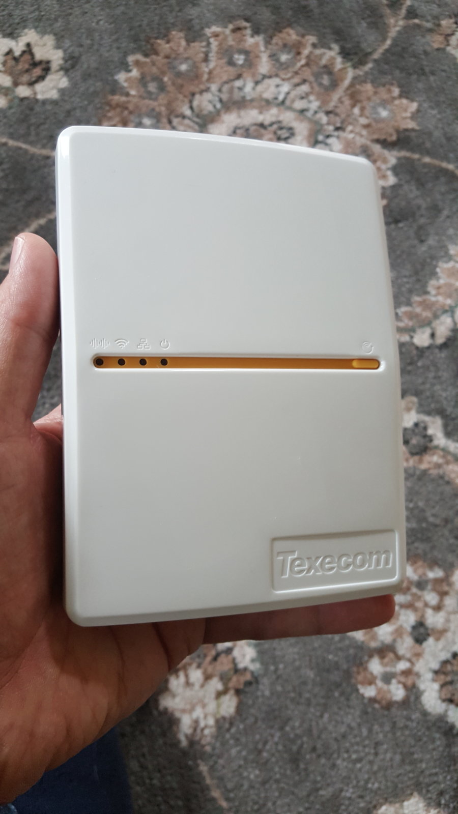

Finally!

One problem - no Android app. Who still buys Apple phones??
Wonder if this system is going to be reliable as their current push message system at the moment cannot be relied on.
hi,
I have had a trial unit for some months now and its good, however it is only on iOS 8.2 and above, so iPhone 4s and above I believe.
as for reliability think we can say its too early to be certain wrt to notifications and its only the Ethernet version available a the moment but its cheaper than a com ip unit.
You can use the new iOS ap and the old app in tandem, however the usual issues are to be expected with the old app.
as the smart com uses two com ports, one for connection via the smart com and one for outgoing as messages it does mean that connecting to the panel will be easier using the app or wintex.
The old app, you need to program old arc details and portforward on com port 2 set as com ip.
You need need the panel to be version4 and flashed up, wrt the ricochet plug, it works well using the recipes, I set the plug to go active on entering a room, the delay between pir activation and plug turning on was minimal, almost instantaneous.
The advantage of the ricochet plug is two fold, runs off mains so no batteries to replace and can be used to extend the network and even if you don't use the plug with the app its pass through so could be left turned on and utilised, or if your lazy you can turn the plug on with the app.
Older versions of ricochet expander, the version of the expander will mean that the soft mesh wont be available for when the ricochet plug is added so if moved it needs to be recomissioned, however on the newer expanders it will do a soft commission process so no need to worry about the mesh being set up.
believe most places have them in stock as of sometime next week and ADI tell me they have some in stock now.
Lack of Android support is pretty poor though, especially given it is the most popular mobile OS in Europe. I notice they've removed most references to Android on the website.

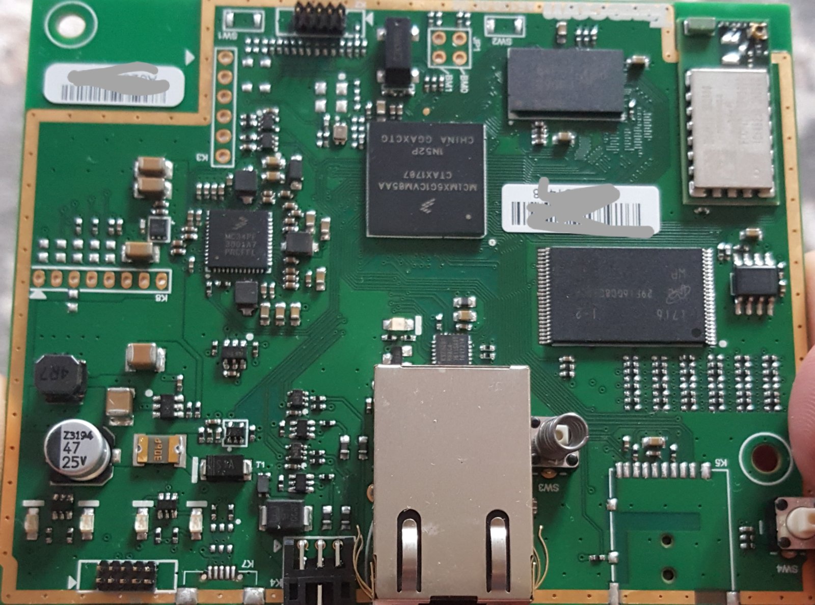

PCB image attached. Interestingly has an SN8000 802.11 b/g/n WiFi module fitted despite being the Ethernet only module. SD cards reader and USB not populated although the manual points to future use for these suggesting they should be there.

the wifi isn't turned on yet so they say, the trial unit did give access to the wifi connection
I suspect the usb will be populated when the bring out the hub versions as some additional hardware is required.
when the hub launches I am expecting it to be more expensive, and it will incorporate the smart com and additional bits and Adrian has said as much, but the hub is phase 2.
never opened the unit up to pcb level.
Quite a powerful CPU. I think they need to redesign the panel and its OS. Could probably place everything on that CPU and have Ethernet included on the main PCB without the need for serial COM port connections. It still amuses me that Texecom cannot have two processes conversing over one COM port to the Ethernet CPU. Alarm panel tech is three decades behind, with new features bolted on in an attempt to survive :(
