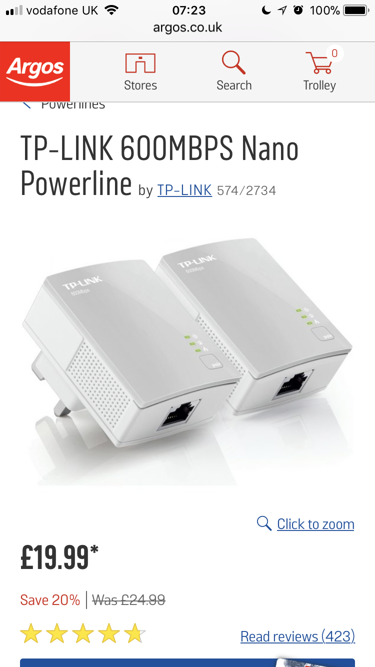

what do you think of this one?
If you have an old wireless router lying around, you might be able to flash DD-WRT onto it to get the Wifi bridge functionality for free.
Personally I'd go for a wire (Ethernet) if at all possible - however PowerLine Networking (PLN) are ok for a temporary solution, I'm using a couple of TP link ones to give a 500mpbs connection (more like 300mbps real world) into my new office before I run Cat 6 to a proper rack the house. (I speak as an IT professional, not an alarm one, WiFi is a flaky beast, and I'd not use it for anything which needs a reliable 24/7 connection).
However every now and then I have to reboot one of my PLN TP links as it just kills the connection. Not the best quality, but they do work.
