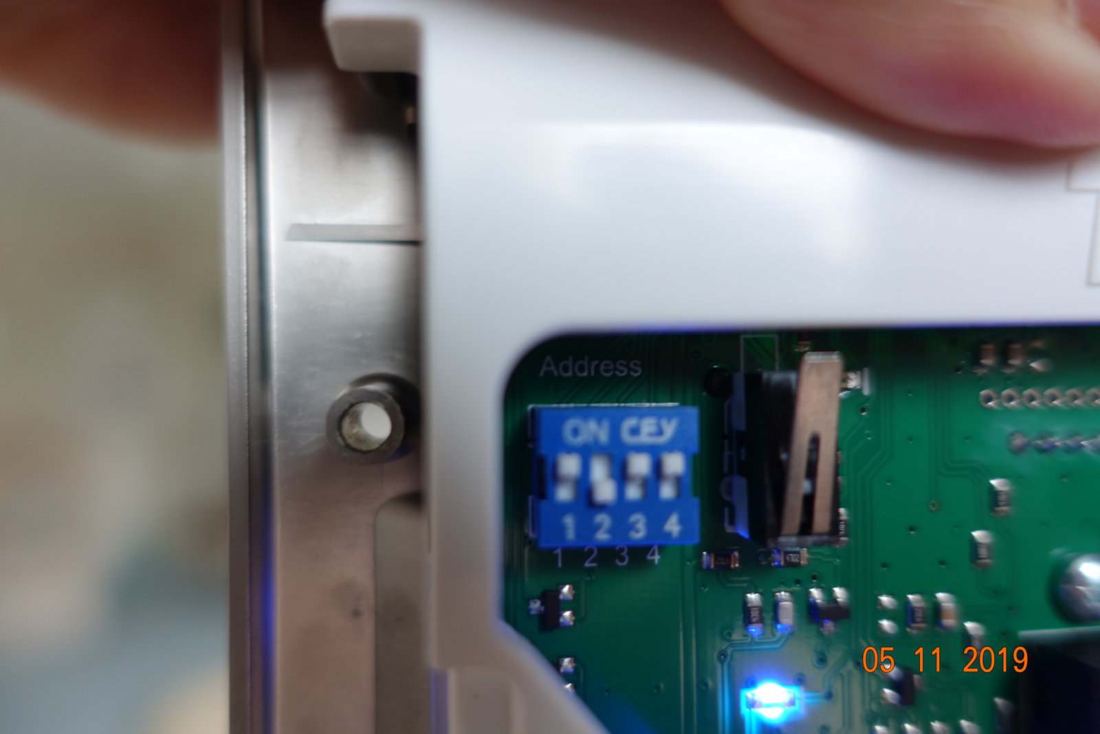

Had a look at the dipswitches, and you have now got me wondering, the switch has on one side 1-2-3-4
ON CEY l have the toggle pointing this way, thinking it is on, but l can now see it should be pointing to one of the 1-4 numbers, that is so confusing.
l will try it tomorrow, and let you know. l feel so stupid.

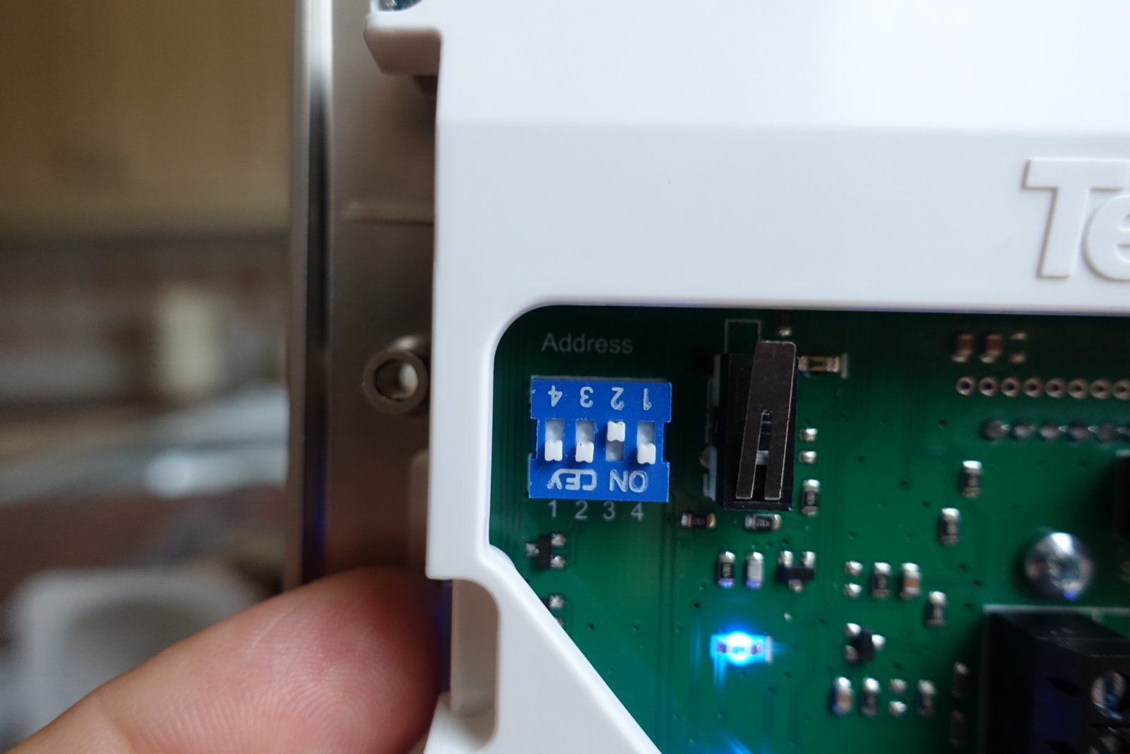

DSC02660.JPG DSC02665.JPG DSC02666.JPG l have sent you 2- photos of the downstair keypads , l think you will see where I went wrong, 1 of the dipswitch modules has been fitted upside down.

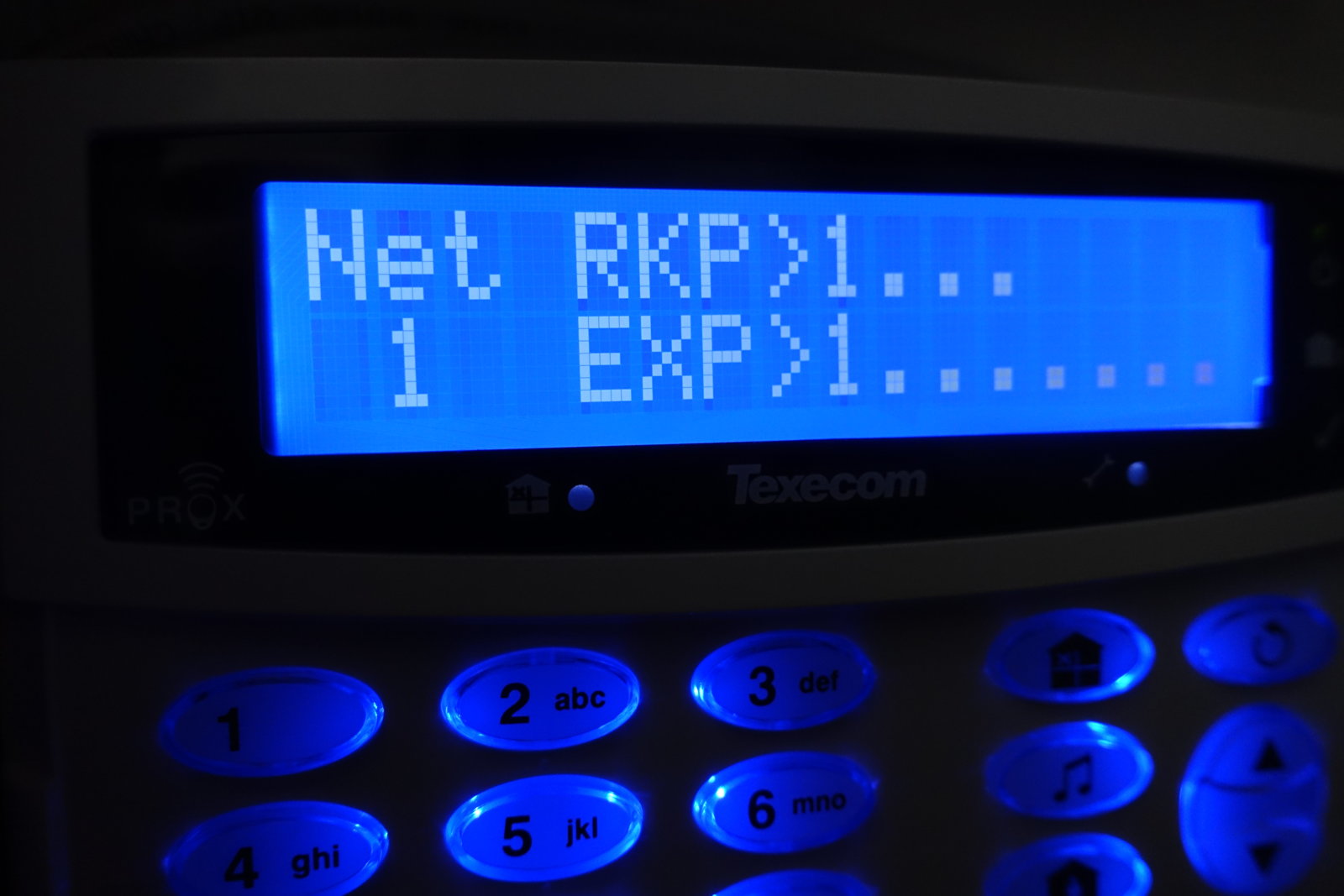

Also a photo of the upstair keypad beside the panel showing "CONFIRM DEVICES", should it not be RKP>123 ?
yes in confirm devices it would be 1 2 3, but say 1 was address 2 and the others 1, it would only show 2 in confirm devices.
so that looks like address 1 is correct and you need to change one of the two's to a three
Think the one being upside down is throwing things out for you.
Don't think I have ever had one upside down.
You can check the address of each keypad with Yes and menu, and the Add being at the top right of the screen.
the 64W has keypads 1 to 4 available to it so as long as they are addressed between 1 and 4 and are all different you should be okay.
