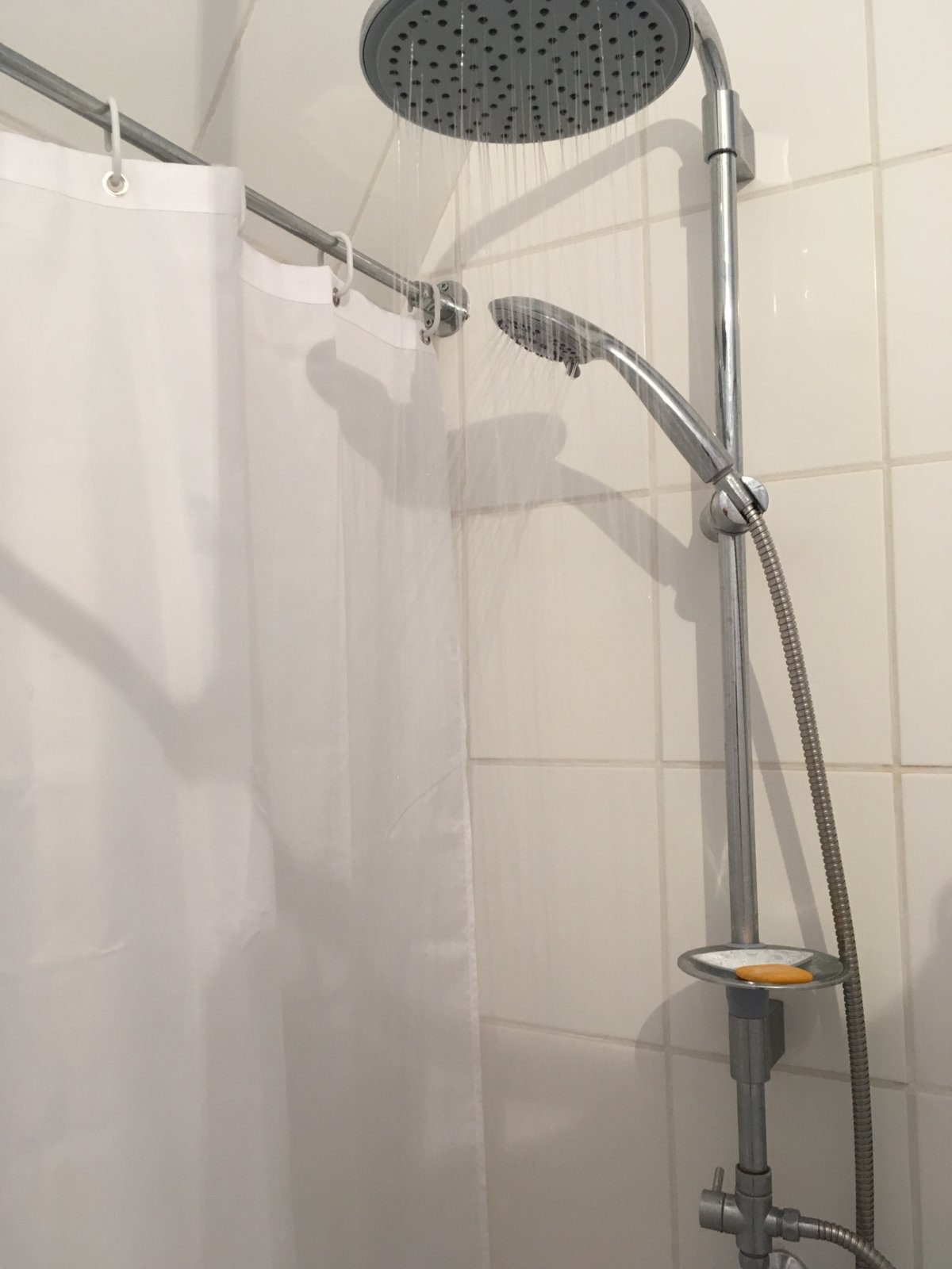

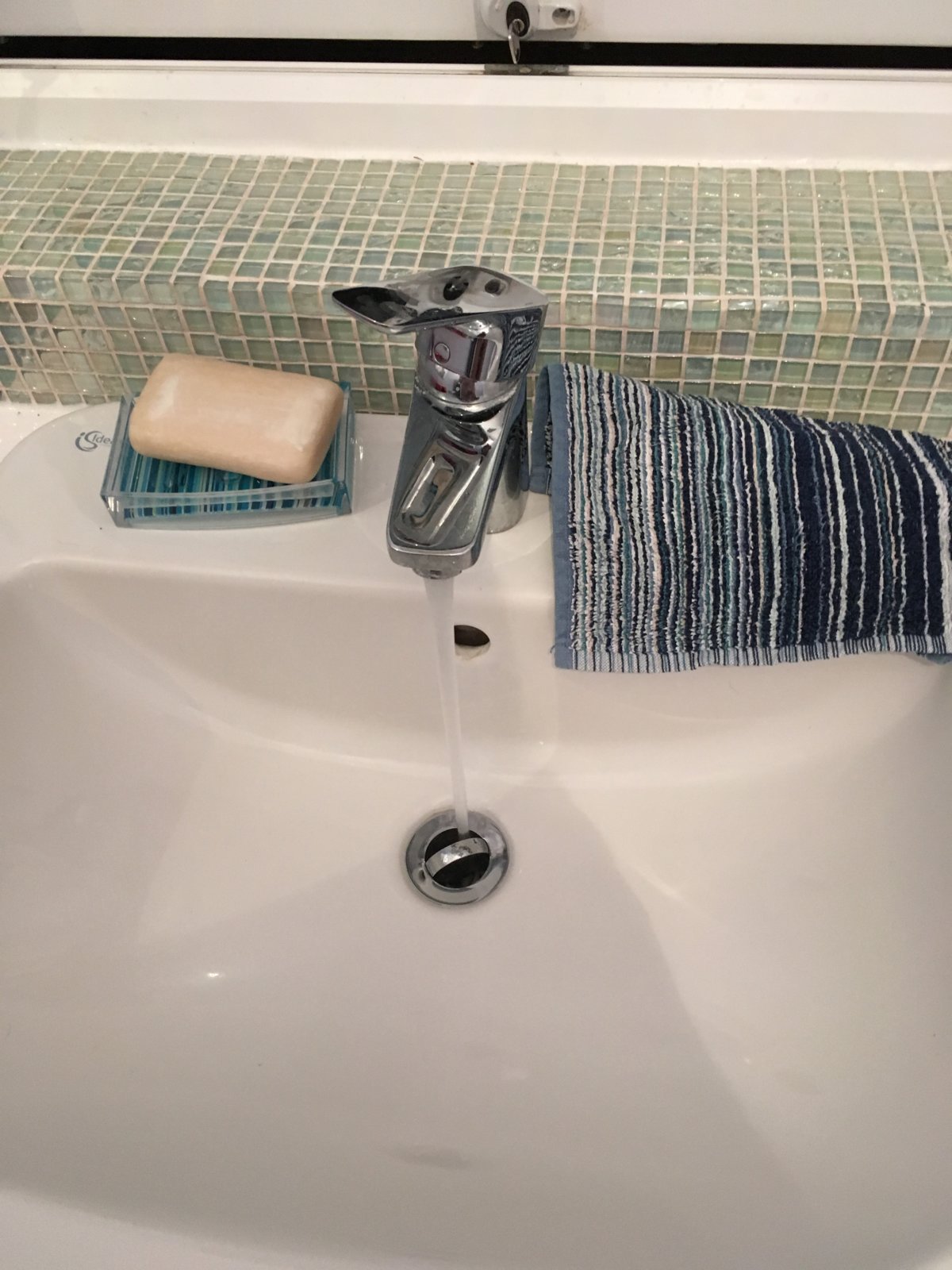

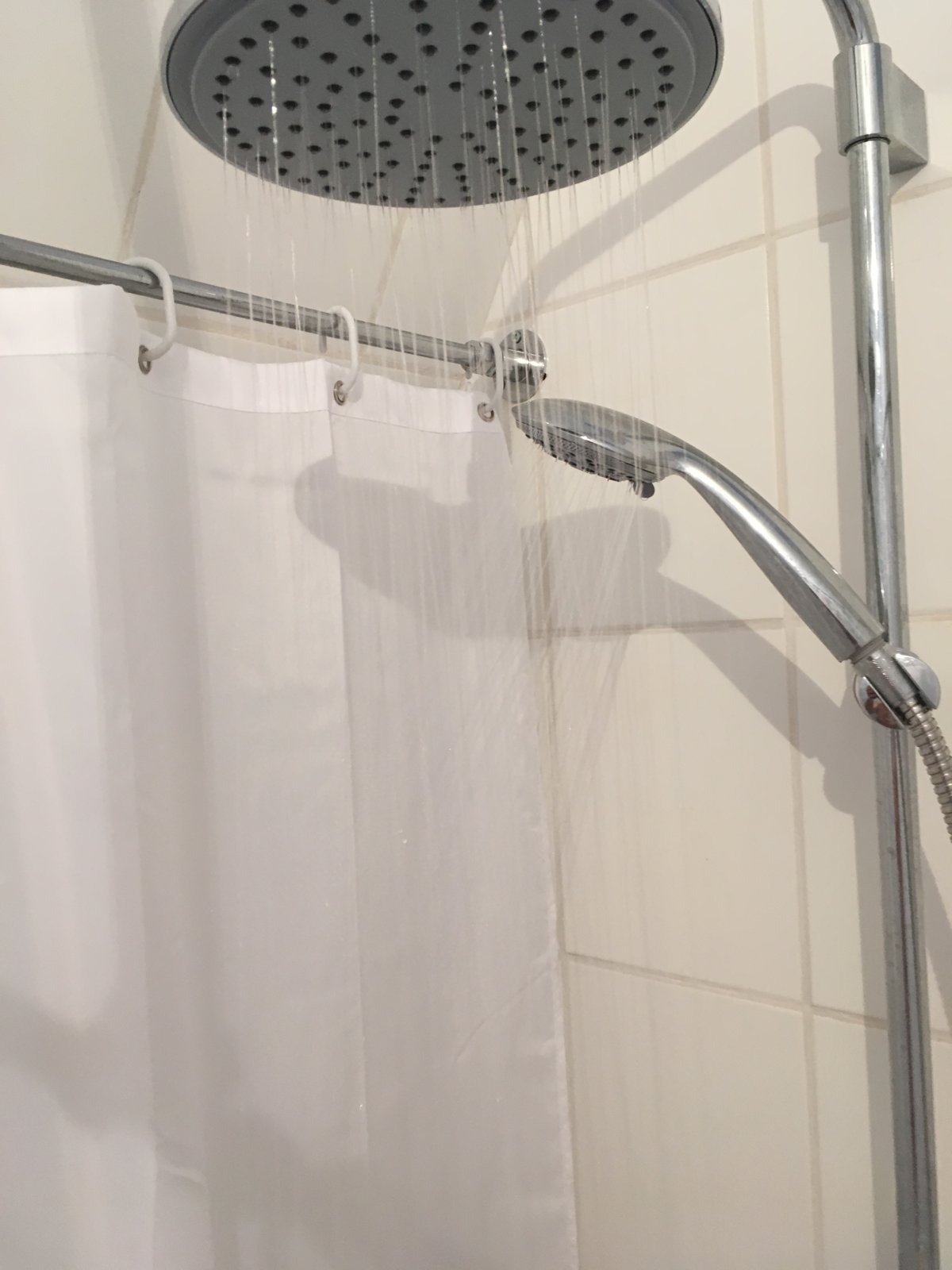

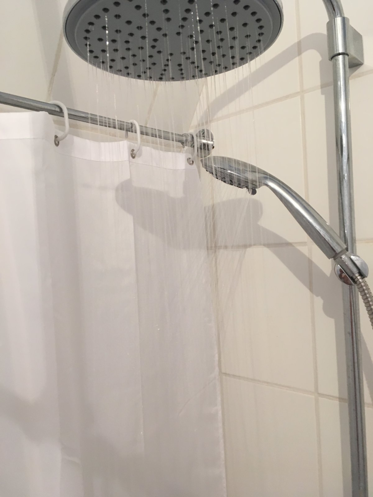

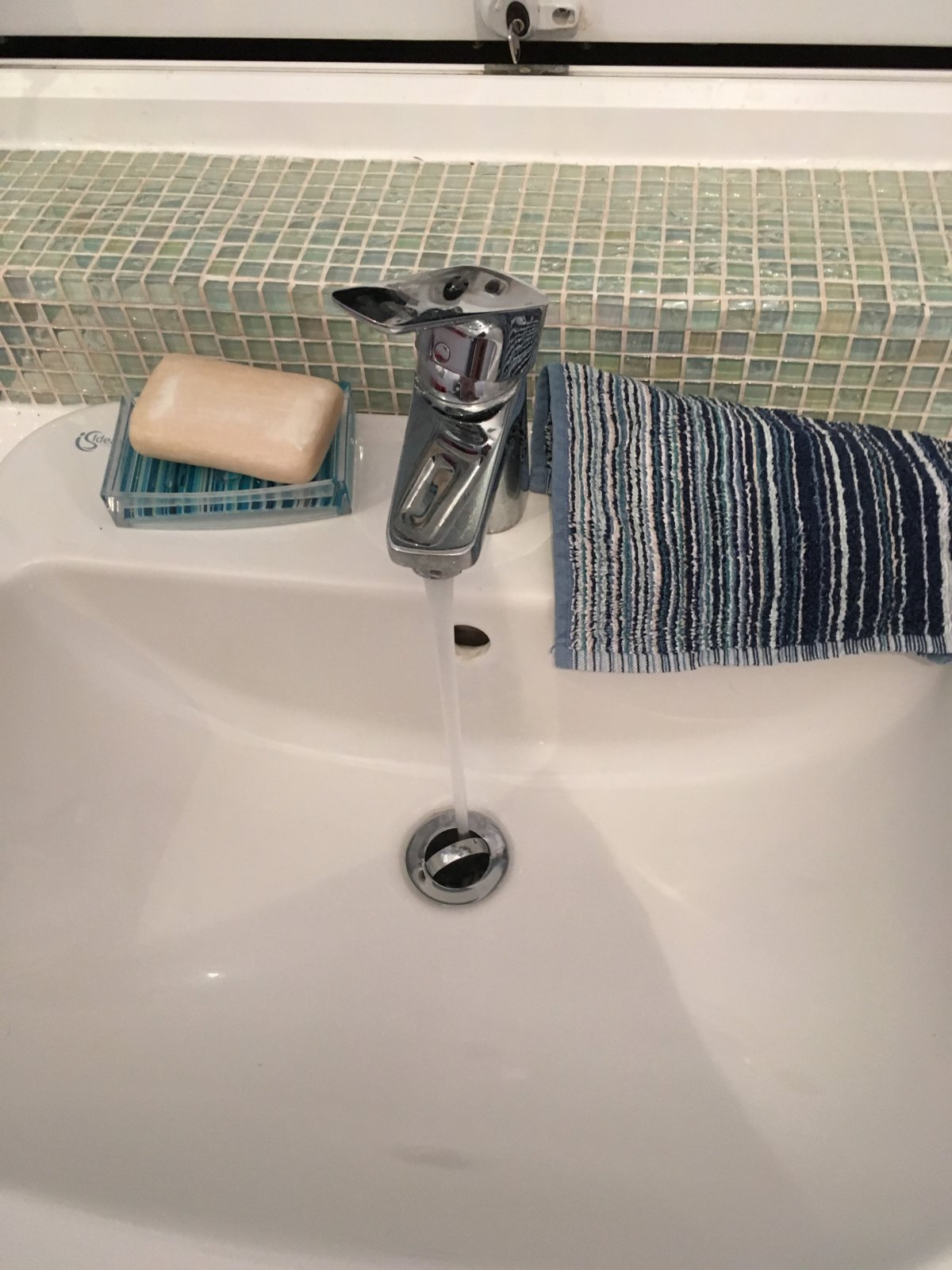

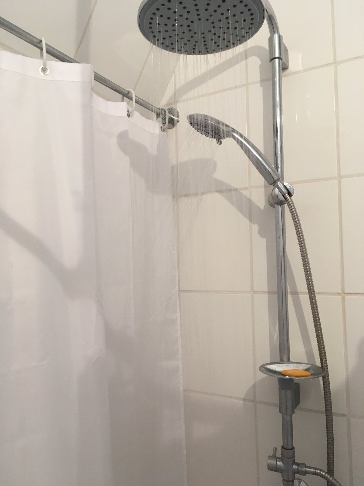

Not sure if the spray will show up but these are two roses running the same time from one shower control with the adjacent hot tap on the basin running also only hot. The showers were hot and cold mixed to a bit below too hot for me. Not very scientific but you get the idea.

Er.... yes!
But what are those three pictures meant to demonstrate?
A combi providing hot water, useable hot water, to two shower roses and a hot tap simultaneously, sort of answering the question in a demonstrable way rather than just writing and giving an opinions.
Obviously a combi can provide hot water to a number of outlets at the same time. The flow rates at each outlet can be manually adjusted to "balance" the flows to levels of flow that are acceptable for those using those outlets. When some one or some thing (*) changes the flow at an outlet and thus disturbs the "balance" the flow rates at other outlets may become un-acceptable, ( or in extreme unbalance, hazardous )

Vulcancontinental, is that hot water by any chance being provided by a Vokera boiler?
But the flow rate looks, as far as the photo seems to show, a pretty poor flow rate from each outlet.
It would have been better if you had moved the hand shower to the side so that its flow could be viewed on its own.
To complete the picture it should also have shown the rain shower being used on its own.

I'll have a go at that and video it if I can with a thermometer to give you temperatures. Remember that this is one shower but with the selector set in mid position to supply both outlets and the basin tap on hot only all running simultaneously. It is indeed a Vokera boiler, my own house though of course a lesser boiler of similar power should perform the same with the same cold supply. Might try to get flow rate too though difficult with the large outlet.
A rain shower is easy to flow rate if you use a volumatically calibrated bucket !
