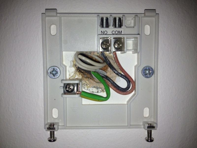

Hi all,
Sorry to post a problem which is probably quite routine. I've looked for answers but the wiring seems to be different in every example.
First of all, the thermostat is a Timeguard TRT033, the boiler is a Glow Worm Flexicom 24 cx.
I just tried firing up the central heating for the first time since moving into this rented place. The heating came on, however the boiler indicated that it was receiving demand even once the temperature in the house went way above what was on the thermostat, and the thermostat itself is not signalling that it is requesting heat. If I do turn the thermostat way up, it clicks on and off fine.
I tried taking the thermostat off the backplate to look at the wiring, however it doesn't match other descriptions such as on the wiki of this website. There are four wires: brown, black, green/yellow, and white. Brown is connected to COM, black is connected to NO, and green/yellow is connected to what looks like an earth symbol (you can just make it out in the picture below). The white wire is not connected to anything.

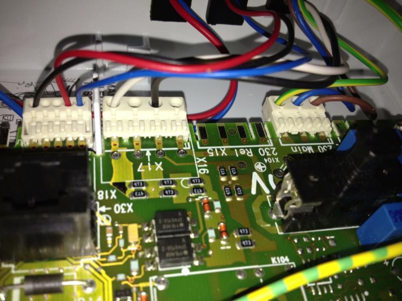

I tried opening the boiler to see what was at the other end of each wire, however the connection point is not accessible. I did take the cover off, and open the control console, but there is another unit inside which sits between it and the big grey wire that comes out of the boiler, so I can't say for sure which wires match up, and regardless they are pretty much unlabelled. I'll include an image anyway.

The earth green wire is just parked there, the other two are simply connected by a switch in the stat changing them would not solve anything.
Leave the wiring as it is, either the stat is faulty or the boiler is firing up for some other reason.
It may be a fault on a valve, but too many possibilities really.
If it has a valve that has "gone walkabout" it would keep giving heating even if the timer and thermostat were removed :D

But if the wiring is fine (and in my case it does seem like I've got an earth wire going to the dud terminal, whereas in this guy's he has a useful one) then I'll get on to them.
