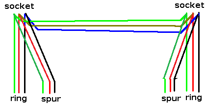

So after the modifications it would look like.
That's perfectly valid but getting all that in the space will be tricky, depending on where the cables run and how much chasing out you're comfortable with and how much decorating etc, this would be preferable:

That's perfectly valid but getting all that in the space will be tricky, depending on where the cables run and how much chasing out you're comfortable with and how much decorating etc, this would be preferable:View attachment 197716
EDIT: Hands up I hadn't seen there was a second page. Scrub my drawing:cry:

Am I right in thinking I am creating a loop and will one chase fit both cable lengths/is that acceptable?
Once I figure out the other cables, isnt that wiring already considered a spur so I need to keep it in the circuit?
Sorry, haven't read it all and missed the fact that it had three cables.
One of the cables will be a spur, but you can add another if you can get them all in.
If you can't then you will have to extend the ring as you said. You will obviously have to get the right two cables.
