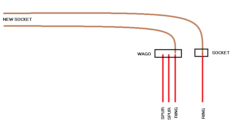

Before it's too late, the cables shown in the new socket on the left look very short, you need another two inches.
Hey spark, it's okay. I have loads of extra length on the right side of the photo. Thanks for making sure that was clear.
Yes, but it would look more complicated with all three lots of wires.
Not to mention the actual wires will not be nice curves and straight lines.

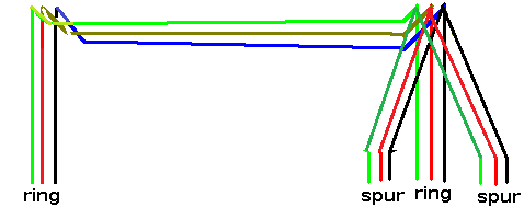

I assume you have proved the 2 cables in the socket are the ring and it looks like one runs off to the left.
The joists run left to right.

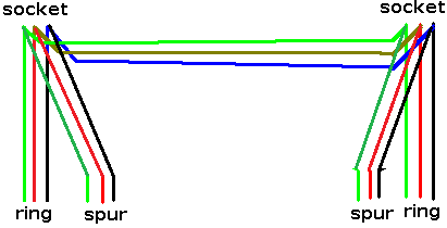

Question:will that cable lift out through the gap and will it reach the other socket? If it will then you can do away with one of the horizontal cables and the connectors in the back of the socket. It will mean another vertical chase below the new socket but it will tidy the wiring:
Even better if one of the spurs will move too:
I don't think the wires in the socket are the ring, I think it's the other two cables.

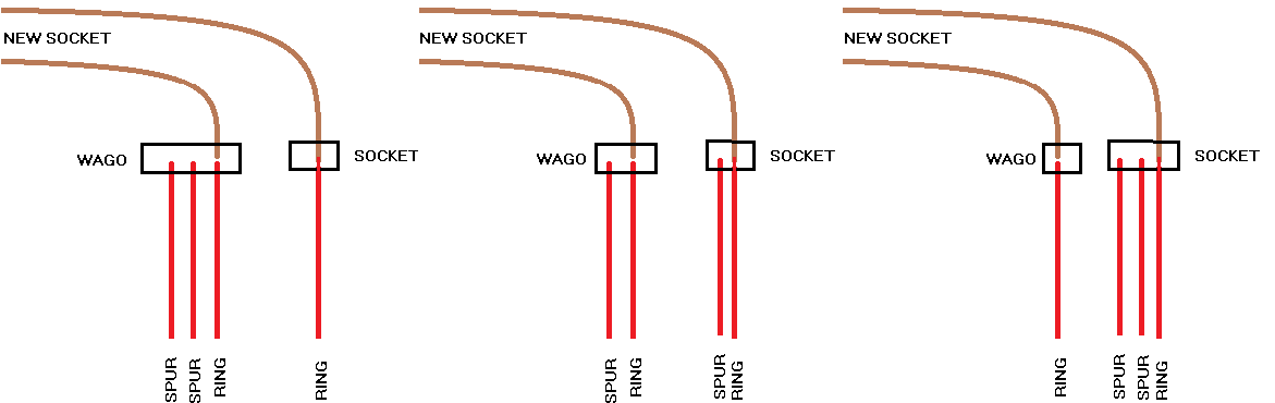

I'm almost ready to fix the wiring but still a little unclear on this because Wacos only have a maximum of four holes and I'm now trying to introduce two more cables.
full
Just to confirm, if I am looping, it won't be wired like this will it? This to me implies two spurs (I am not very good at reading wiring diagrams).
You do have 2 spurs so the final arrangement can very well be like this with 4 wire in each wago.
Going back to EFLs simplified diagram showing only live wires [red and brown] there will be 4 wires in the wago, however if it's more convenient it could be done with only 3 or 2 wires:
