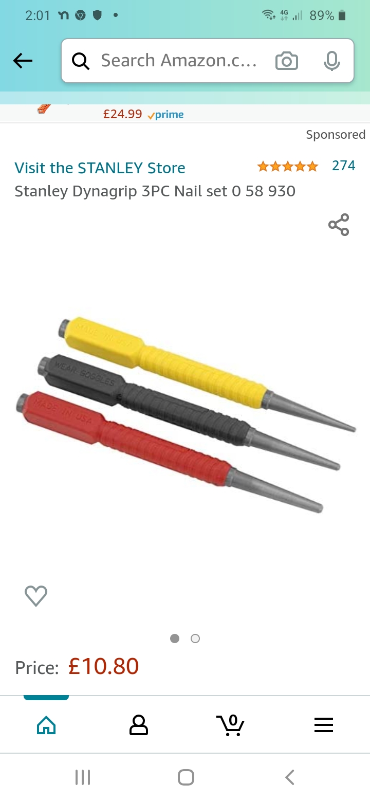

These?
You use them for punching nails e.g. on skirting below surface?

I'm old school.in this respect - a nail set (NEVER a punch, which is IMHO a misleading modern term) is a form of tapered punch with a hollow point (to better locate on nail heads) which is used to "set" a nail or pin head below the surface of material. If you use it as a general punch to mark stuff or make holes you will destroy the hollow point and your set will forever after be sliding off nail heads when you hit it and damaging the work. Once you have cream crackered the end there is no way on earth to regrind it yourself. Which is why they should be thought of as NAIL SETS not general toold
Incidentally, misuse of these is one way old carpenters like me can tell if they are dealing with a tradesman or a chancer

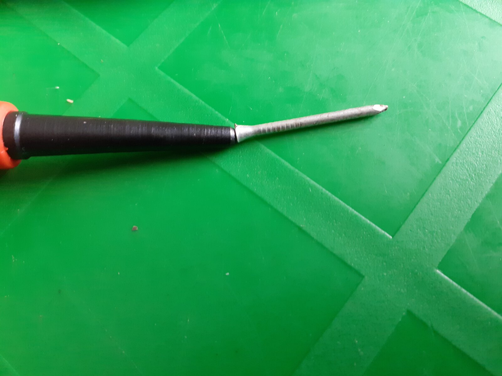

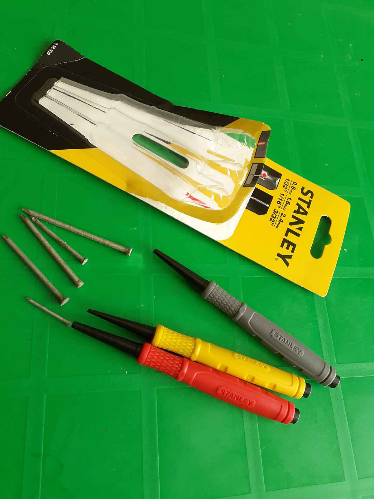

Do I need wider nail sets? The fattest (red one) is same width as width of nail head. Nail doesn't fit inside the nail punch at all
No. The bigger head nails don't need to sit inside the hollow. Just make sure you centre it on the nail head and strike it vertically. If you are not holding it vertically it may slide off and damage the surrounding wood.
