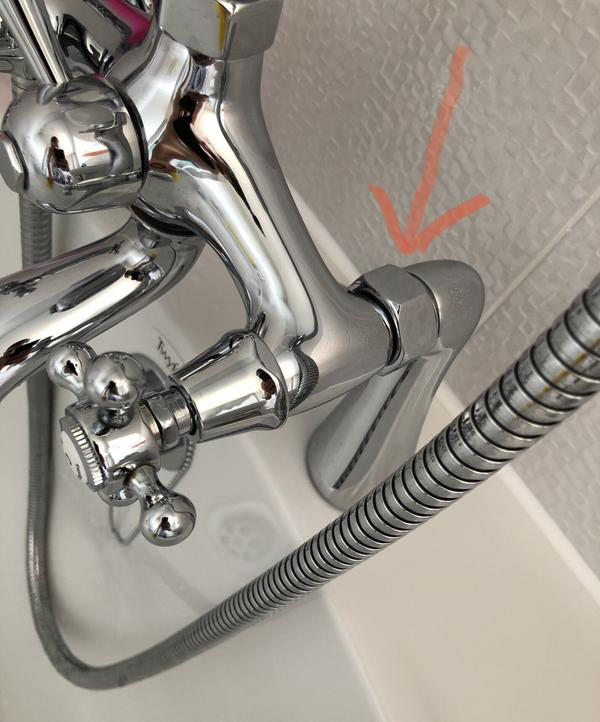

Fixed it!
So decided to go back over my work with the bath taps as that's when this issue started. Found this nut which I had not touched to be a little loose. Not leaking water (did have a stain underneath so had leaked a bit) but if I wiggled the taps it opened up and water did come out of the joint.
Cleaned that up and tightened. Once back together and water on the basin tap is restored to a very pleasing gush! I think more so than it ever has.
Can only assume it was drawing some air at the bath taps when I opened the basin or toilet tap? Odd one.
Thanks for your help. This one drove me mental.
Hopefully this is the end of it.
