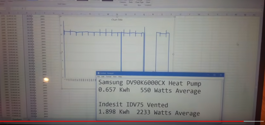

OK Fark!! We have an answer here, almost the same tumble dryer i have and look at that. Almost 4 times the power draw of a venter tumble dryer. Screenshot for those can't be bothered to watch whole thing and or youtube link below. Ok fck that im keeping my heatpump dryer!!
1898 divided by 657 is actually about three times.
Though I didn't see him compare before and after weights to see if the same amount was dried.
