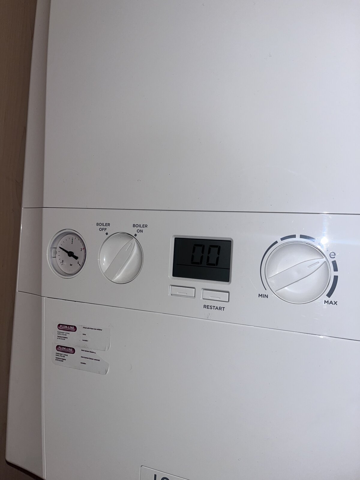

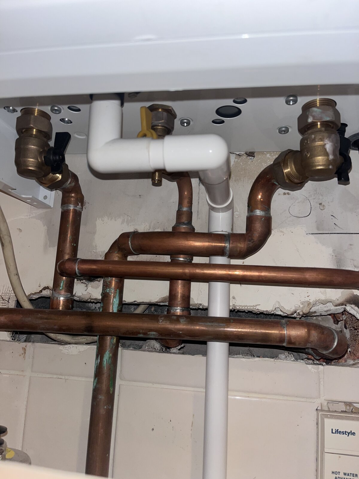

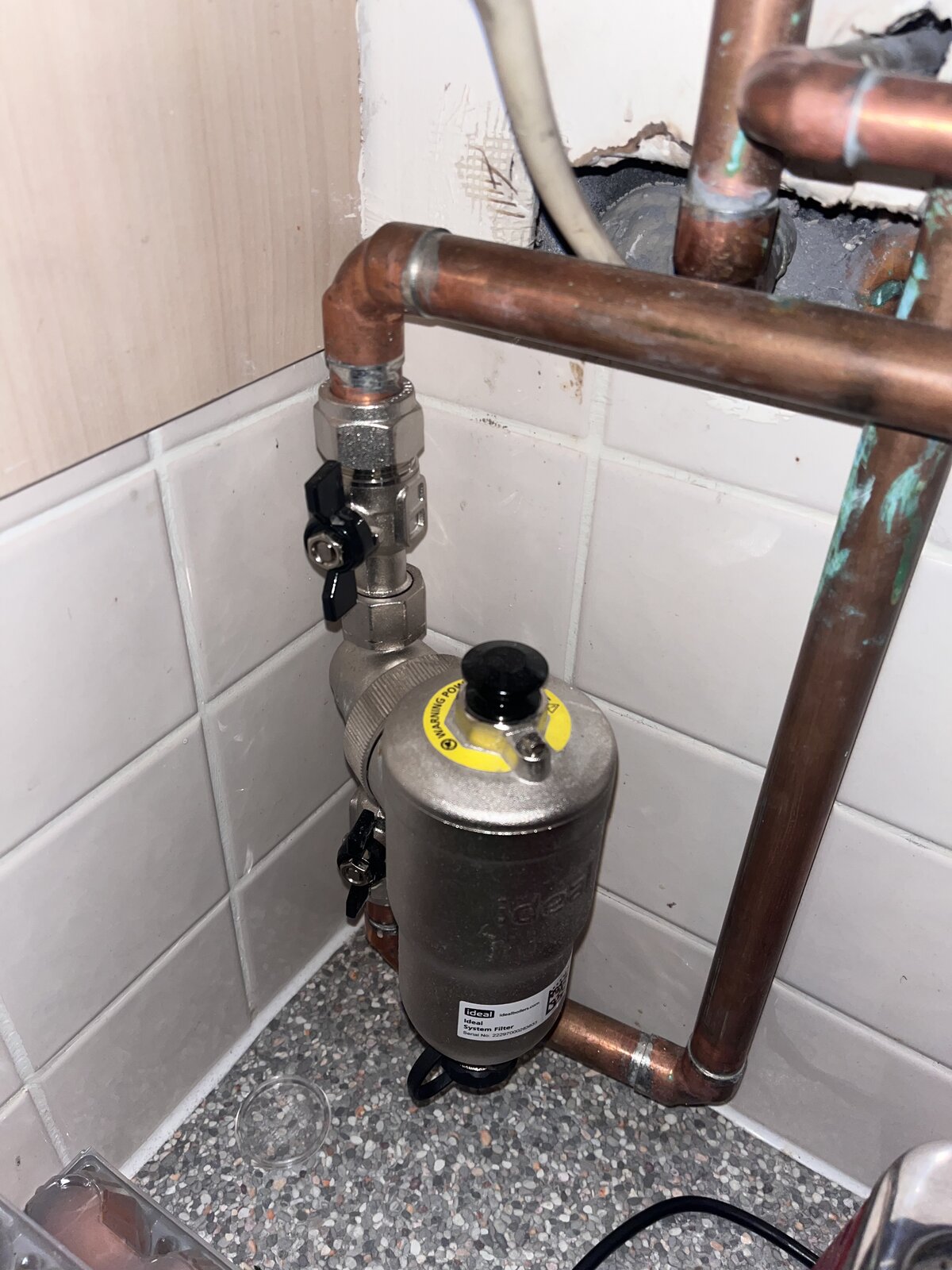

This is inside
The first photo is a magnetic filter, to help prevent rust and debris, blocking your boiler. Search for the manual online, and it will explain how to clean it out. For heating, and for best economy, you can turn the Min/Max temperature down, as low as still keeps the place warm, but for heating the cylinder it may need to be set higher, to ensure the hot water gets to the temperature set on the cylinder stat.
Cleverer systems, have two boiler temperature settings, one for heating, one for hot water, but you have only the one setting there.
Best to just keep on e?
Yep, so long as it manages to satisfy the temperature demand, of the cylinder.
Boiler temperature, needs to be around +10C above the cylinder stat setting, otherwise the boiler will constantly cycle, and fail to satisfy the cylinder stat setting.
