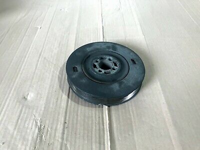

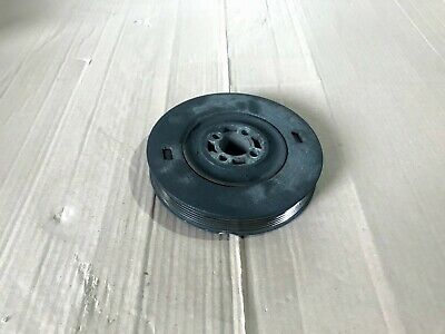

hi
this is crankshaft pulley isnt it
if it is on firm without movement does that mena it is completely ok ? I had a quick feel earleir and it felt fine but that was only with ym hand movements
I would say the crankshaft pulley (Harmonic Damper) will be starting to delaminate at 190,000 miles.
Take belt off and double check the rest first though!.
