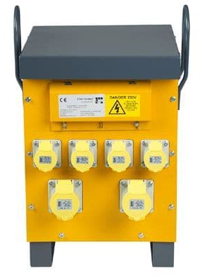

Lets consider a hypothetical non-isolated version of of the yellow brick. We still want a 55-0-55 output, so we have an autotransformer wound with a 55-0-55-230 configuration. We connect the supply neutral to the "0" tap, the supply live to the "230" tap and the output to the "55" taps.
Now lets consider what happens if the supply neutral conductor breaks. With a traditional yellow brick our output just turns off, with out non-isolated yellow brick both sides of our output rise up to 230V.
Even worse, lets say the supply live and neutral are reversed. Out traditional yellow brick doesn't care, but our non-isolated yellow brick now presents 175V on one side of the output and 285V on the other!

With a 'floating supply', one can only get a serious shock by simultaneously touching two 'poles' of the supply. However, if one 'pole' is earthed, then one can get a shock by touching the non-earthed 'pole' simultaneous with being in contact with 'earth' (including 'the earth') - which poses far more opportunities for shocks.
It doesn't. However, as above,what it does do is create an opportunity for someone in contact with 'the ground' to complete a circuit if they also touch the non-grounded side of the (now earth-referenced) supply.
And that touch voltage is now no higher than 55V - whereas with multiple faults (or combinations of fault) the touch voltage could easily be 110V
eric argues that by earthing a point on the secondary, one is facilitating RCD protection of circuits/loads connected to the secondary. Whilst that uis certainly true, as you know,, my counter-arguments are (a) why bother with the transformer at all (for 'isolation', rather than voltage change), if one is going to 'bypass' that isolation? and (b) as far as I can see, if the secondary truly is floating (no connection to earth) then RCD protection is not really required (unless one postulates multiple independent simultaneous faults) and only becomes required IF and because one earths a point on the secondary?
Bear in mind that the yellow bricks are mainly aimed at (e.g.) building sites where the people working with electrical stuff are not renowned for their careful adherence to safe working practices and molly coddling the tools. Rather than postulating IF a fault would be allowed to continue for long enough for a second one to occur and cause a hazard, I'd suggest it's more a case of the expectation that "if it's still working it won't get fixed" and the question is merely how long till the second fault happens and the full 110V L1 or L2 to earth that's been there for days, weeks, months, ... gets exposed.
Given the expectation that faults will be common, limiting touch voltages to 55V and hence making the hazard very much lower would seem a sensible option. AIUI, it's the limiting touch voltages to 55V that's the primary aim of the "yellow bricks".

... with a truly isolated (from earth) 110V secondary, the potential shock is, indeed, in most situations double that with a 50-0-50 secondary (with centre earthed). However, a shock can then occur only if someone somehow manages to touch both sides of the secondary - which seems to me to be an extremely unlikely happening, even with multipole faults. It is also comparable with someone simultaneously touching L and N of a standard mains supply - something against which an RCD offers no protection.
On the other hand, with a 50-0-50 supply (centre earthed) one only needs a single fault to make one side of the secondary touchable, and then for a person to be at risk of a shock if they touch anything else which is earthed (or, indeed, 'the earth').
I therefore see it as a choice between a very small probability of a 110V shock against a much higher probability of a 55V shock - and, given the potential danger of a 55V shock, I would probably be inclined to favour the other option.
