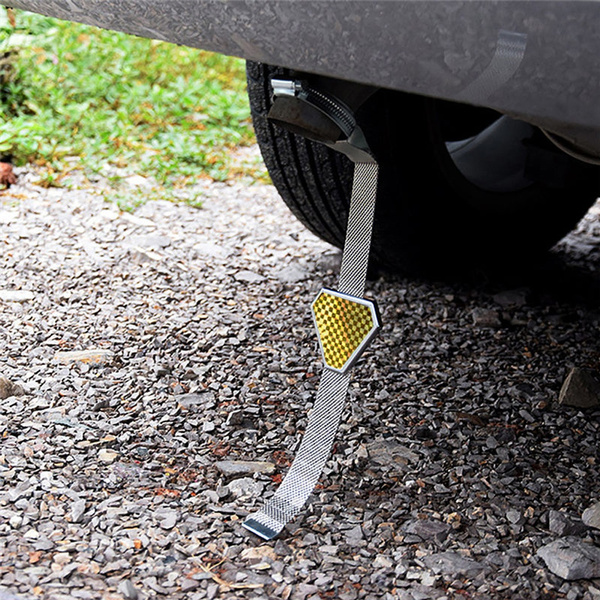

In the old days of cross ply tyres we would often see vehicle earths, however most tyres today like wellingtons have graphite in the mix, so do connect to ground. Hence why wearing rubber boots does not stop you getting a shock.The idea is to get rid of static rather than electricity made by design. But clearly they are likely earthed.

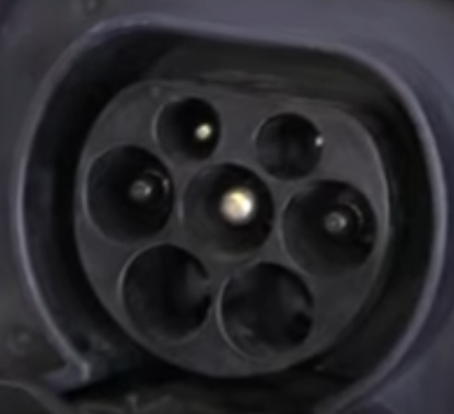

But the whole point with electric cars is we don't know. I assumed all EV cars could charge at 22 kW with a three phase supply but this

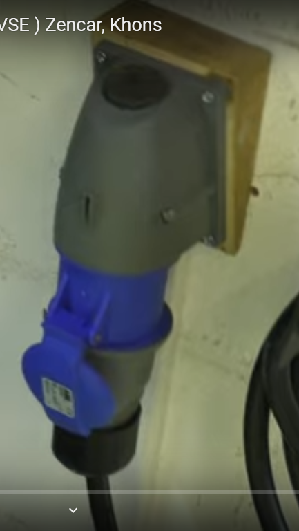

There is a little uncertainty with plug in, this
may supply an EV charger, could supply a welder or any other appliance so is not considered as an EV charging point. So as electricians we are left with very little general information, we can look up details of one car, but we have no idea if all cars are the same.
So be it feed in or out of the car, it may be safe with one car, and dangerous with another, it may even be a fault and the car body may be intended to be isolated, but a fault can caused it not to be.

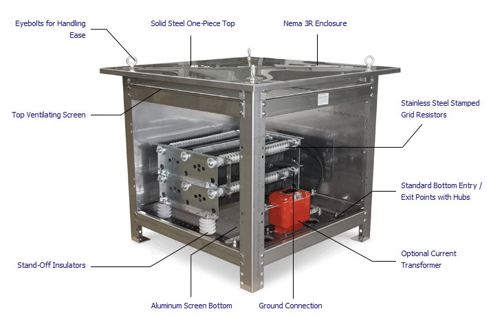

Without such a device there is a problem with over current in earth cables.Neutral Earthing resistor systems protect power transformers and generators from damaging fault currents. Earthing of the neutral limits the ground fault current to a high level (typically 50 amps or more) in order to operate protective fault clearing relays and current transformers. These devices are then able to quickly clear the fault, usually within a few seconds.
