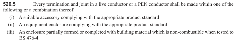

Want to emphasize first, this is not DIY.
Recently had some building work done, and we're just decorating one of the rooms.
There are 2 places where the electrician has used wago to join cable, and then popped them into the wall.
Are these OK to be used like this? They're not in a housing or anything and have just been pushed into the wall. At another area, it's against a block wall so will be filled with plaster which will plaster in the wago. Wet + any type of connector seems like a bad idea, do these not have to be accessible in any way?
No they are not, they should be in some sort of enclosure. Best tackle him on that, it would leave me concerned about the standard of the rest of his work..
Pretty much what I thought. There's a few fused spurs, so looks like the ring main has been extended with the wago connector in the wall.
What would be the actual solution? Connection in the back box, crimp plastered in wall or another backbox and blank faceplate to house the connection?

Only issue is the connection is too close to the socket backbox, so won't actually get the connection in the backbox. Would end up between the 2.
Logically solution would be to pull a new wire through and do it properly. Doubt another electrican is going to want to get involved, and I already asked this sparky several times is they can just be put in a wall where it's not accessible, and he repeatedly said yes.
His interpretation of the regs, and what a wago is classed as Vs mine. Unless there is some official reg sheet from wago explicitly stating this is against regs?
Then if you haven't a;ready paid him, then I would withhold some money, to address his obvious defects.

Interpretation, but would a wago not be number 1? The join us within a suitable accessory, but that accessory is not within a suitable enclosure itself?
The accessory must be suitable for its conrext, which a wet plastered wall is not. My guess is the sparkie will wrap with tape, and whose to say that is less effective than a crimp.

The worrying thing for me is that you begin to wonder how many other cases of bodgery there are on that job....
Not an electrician, but I've worked with one for a long time.
Providing the joint is in the safe zone, he would crimp the cables and use heat shrink.
