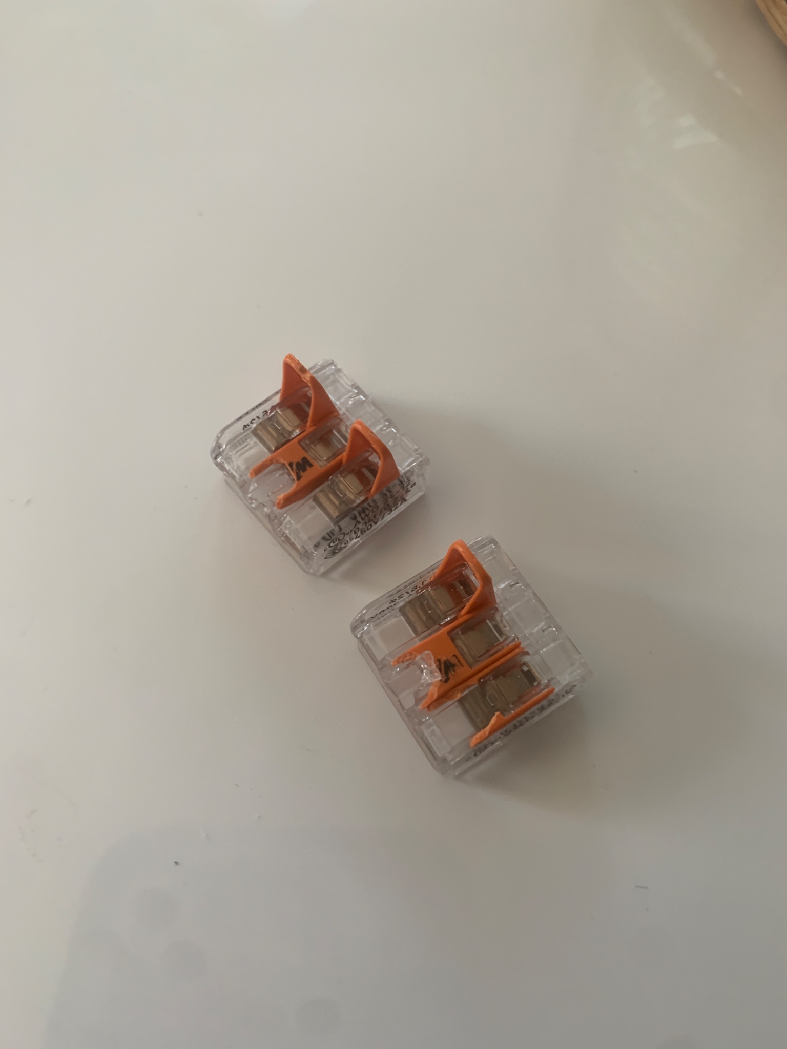

Just tried to lift the levers on 3 wago connectors and only successful with one , levers snapped off on two.
Any one had issues with wago’s?

Not had one snap like that (yet) but they do catch your fingers when you shut them if you are not careful.....
contact wago and see what they say, they might ask for them back to check them and should replace them (with more perhaps??)
I thought you could push fit those ones when closed (ie the lever is only for undo/refitting)
Tend to use rival Ideal connectors more often than Wagos.. I also thought the 221s had more solid orangey looking levers but those seem a bit brittle/faded/snapped-into-a-hoop looking things. Have they been left in the sun for years?
The levers on the 221s are quite fragile, I've had one break when figiting with it.
The 222s have much more robust levers, but are substantially bulkier.
Always stored in a box in a draw.
Can’t push fit multi wire flex only rigid copper .
There are cheap copies on the market now.
That said in the hundreds I’ve used only one has ever broken
No, the wago 221 and 222 series don't support push-in use. Some other brands of similar connectors (and some of Wago's din-rail mount products) do.
