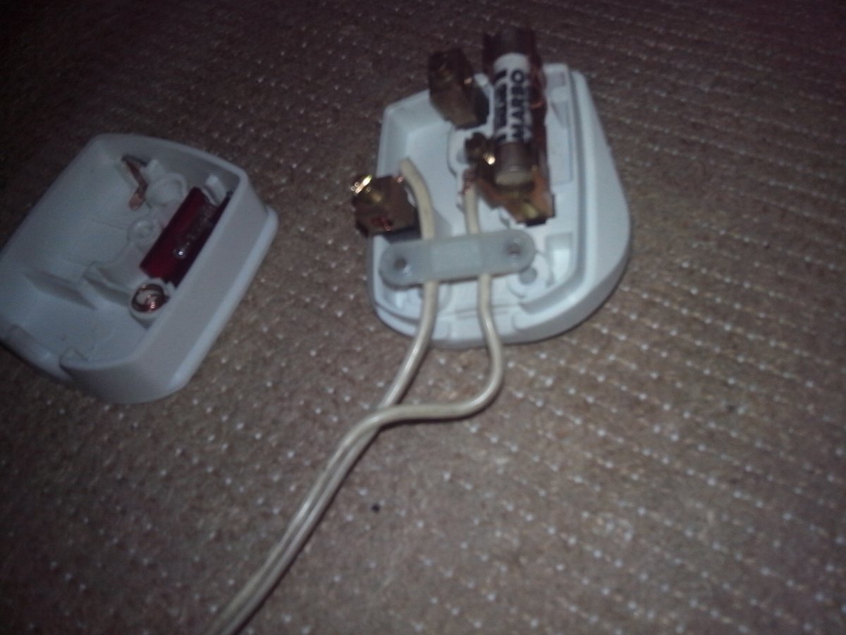

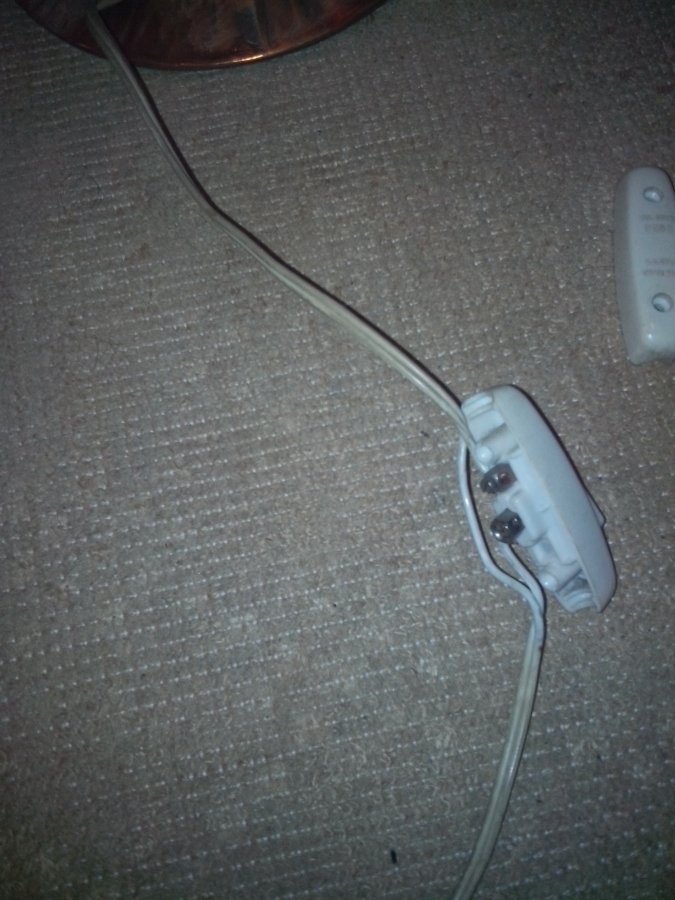

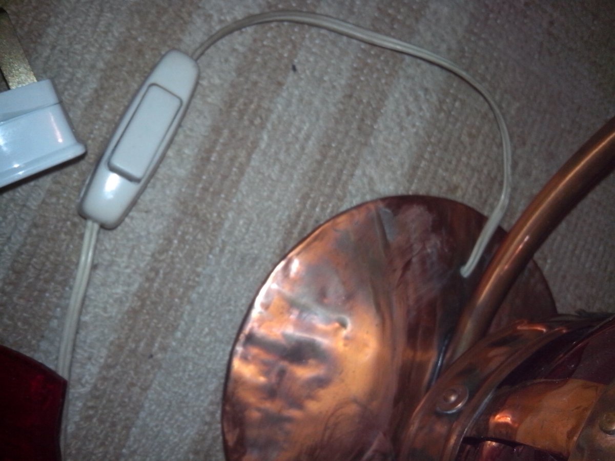

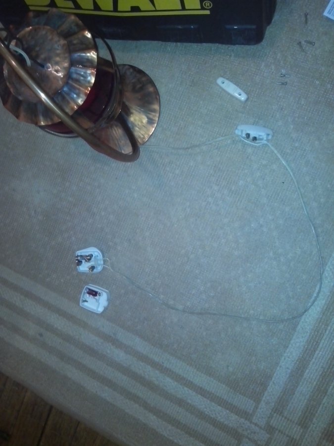

I want to extend the cable but not sure what it is.. and perhaps change the switch and the plug ... would should I buy and what cable should I use? Thanks chaps.

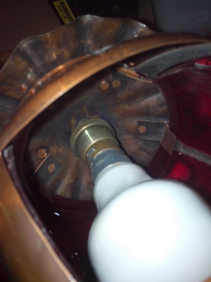

If it was mine I would rewire with three core flex and use a bulb holder with an earth connection. Although you can extend the cable there is a problem if that cable is damaged as the lamp is metal so likely it would return through your body before it blows a fuse.
Yes, i would agree with ericmark. Rewire with 3core and a switched brass lampholder with earth terminal and check the base is earthed. And fit a 3amp fuse in the plug, does that plug have a neon lindicator ?

Yes but the indicator bulb has not been working for some years ...
If I use a switched lampholder I would need a switch somewhere along the cable then ? The lampholder is enclosed by glass.
The most important thing to do is replace that cable with a sheathed variety, and earth your light fitting. As it stands, it's really unsafe.

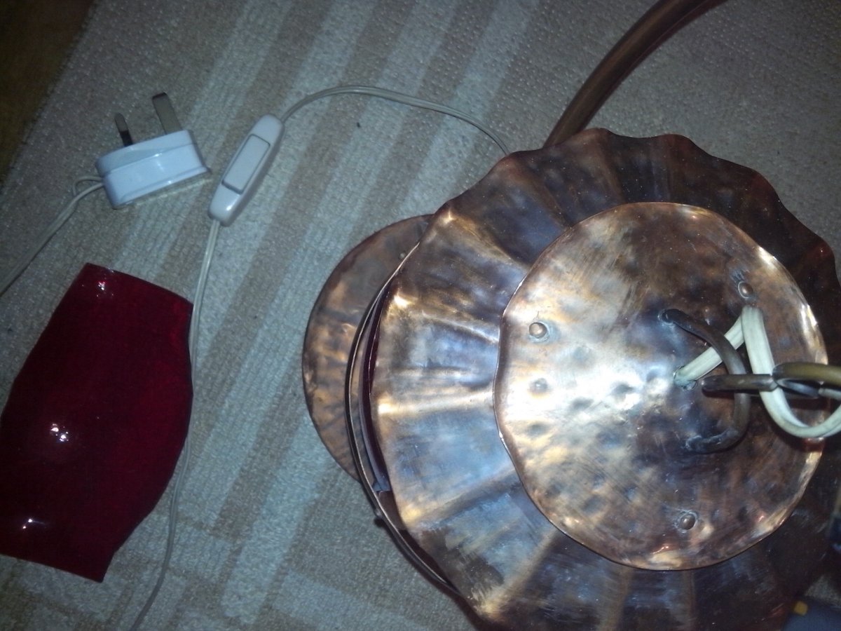

Will a three core flex fit through the narrow openings in the copper ?
It might not fit through the narrow opening in the lamp. In the meantime it will be safer to chop off the old mains lead to this item, to prevent a child plugging it in and killing himself.
Keep it as a decorative non-operating item, if it cannot be safely rewired.
You could make the holes bigger with a step drill, as it's copper it will drill easily.
I can't work this light out though, the cable enters through the base, and then re-enters the top? Is that right? Where is the cable routed to get to the top?
The tubular frame? Just make the hole bigger and fit little rubber/pvc grommets in the holes. 0.5mm² 3core flex is fairly small. I don't think 0.25mm² 3 core flex is meant to be used any more.
