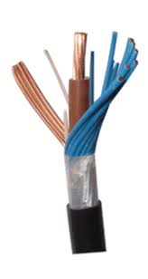

CONCENTRIC is one main core with a ring of outer cores usually EARTH
SPLIT CONCENTRIC is one main core, a ring of outer cores and ALSO a ring of Neutral cores
Err, that's not right is it ?
Yes, concentric is one core with one layer of smaller cores (generally not insulated) around it.
Doesn't split con also have one core and one layer of smaller cores round it - but this layer has cores which are split into two groups (insulated blue for neutral and uninsulated for earth).

Yes you are correct, though i seem to remember there are more blue cores than bare
The blue cores are probably smaller CSA so that with the insulation they are roughly similar in diameter to the bare ones. Thus there'll be more of them to get the same combined CSA.

Yes you seem to be right, never realised that, only ever seen it when already terminated with the outlet bit sheathed over
