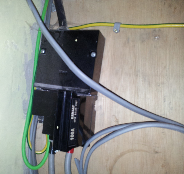

This pic of yours above is what is known as a "cut out, by coincidence it has HENLEY on it as they make a lot of stuff as do other brands, not to confuse with a HENLEY BLOCK which is like the old things in the hall.
The HENLEY block is just an insulated connecter block for big cables.
The HENLEY "Cut out" will also incorporate your MAIN FUSE

I’m going to throw a wild guess out there, that the cutout and meter may have been moved by someone other than the DNO. The original cutout is the one that’s now in the cupboard and someone has fitted something old back in the original position. Look at the size of the markings on the original board
Also that concentric cable is far newer than the cutout. Ever time I have ever seen a cable replaced it always has been onto a new cutout. Always. It looks like a Bakelite cutout off an old overhead service. The cutout beside the meter looks around the right vintage for the cable
My other reason for suspecting this is the concentric seems to be running through the floor void. The DNO are unlikely to have done this as they are not keen having their cable running through the house. Though I suppose if it was a job by the DNO, that maybe why they have left the cutout there to offer some protection

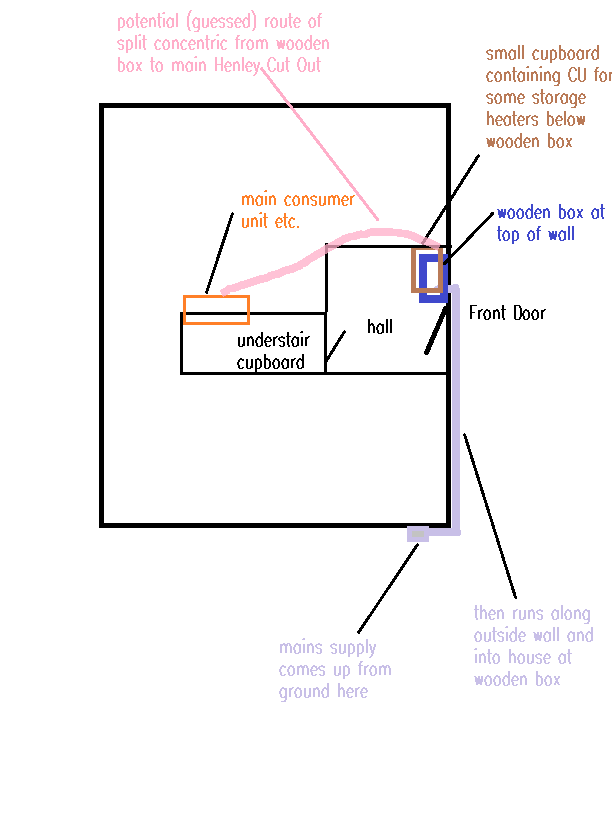

Time to break out MS Paint again methinks :LOL: Here is a top-down view of the location of the various items discussed on this thread.
That seems like a possibility, except the new equipment doesn't seem as if it would match the green paint marks, nor is there any green paint on the new equipment. The new looks very new indeed.
I will go with the green paint marks are as a result of some much earlier equipment and that the DNO has installed a new incomer and someone has picked up and used some old scrap Henly blocks and an old cut-out. They have then moved the DNO's new items to the new position and added new cable.
Would it even be possible for someone other than a DNO to move it?
Yes, not too difficult, if isolated at that old Henly cut out. It would be much more of a risk, swapping the Henly cut-out, as I assume they have.
The DNO has installed a new incomer, they would not reuse the old cut out and Henly blocks.
Also, note how the outgoing split con has heat shrink or sleeving on the neutrals and earths, and not on the incoming. Would have probably been a bit too risky for whoever changed it live to sleeve the cable.

Just noticed the left what i thought was a Henley box is actually joined to the fuse, so that makes that a "Cut out " with a seperate Henley block for the Earths, my apologies
