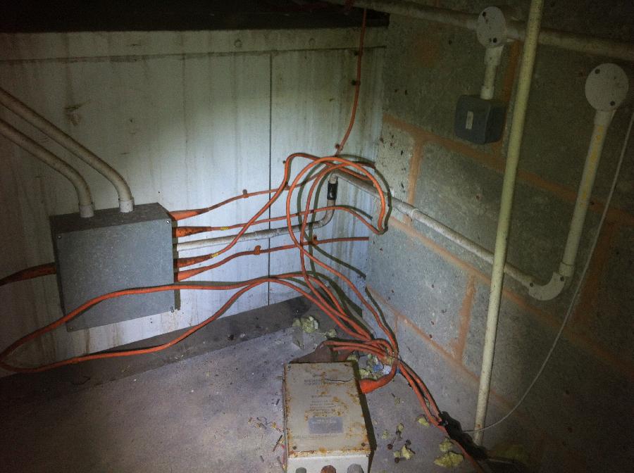

We all love a spankingly neat and tidy install with PYRO, it looks the mutts.
I was on a site today to replace a damaged metal clad socket (actually a completely twatted socket that had obviously been abused!).
Turned out the socket had taken the brunt of abuse from folk as it did not work. This turned out to be due to a blown fuse. This turned out to be blown by a very poor insulation resistance. This turned out to be due to a dodgy PYRO pot. This turned out to be located here.....
(remember, we all love a neat and tidy pyro install!) http://www.askthetrades.co.uk/gallery/Lectrician/1333138399.jpg
Is that one of RF's early efforts when he was training?
He's certainly improved!! :lol: :lol:
