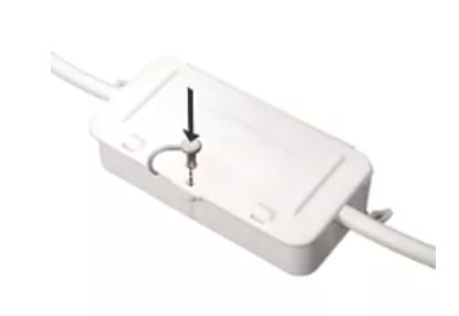

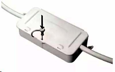

IIRC wagoboxes are supposed to be ziptied shut, whether people actually do is another matter.
You can get a connector box openable sans tool.
  • Thanks
Reactions: CBW
It's only openable 'sans tool' if one doesn't screw the (provided) screw into the (provided) hole. If you make the same error (failing to install the faceplate/whatever screws) with any electrical accessory, it would be equally openable 'sans tool' (in fact, would usually be difficult/impossible to 'close'!)

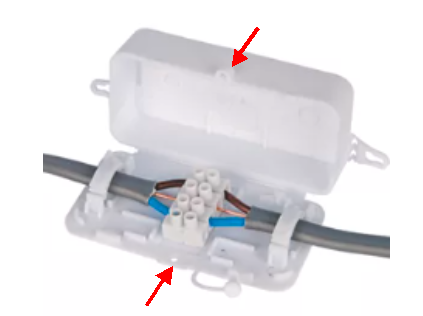

John, the ones I saw only had a plastic peg holding the lid in place.
I don't know what you 'saw' (I suppose that depends on the extent to which you were 'paying attention' :) ), but the Screwfix listing you linked to included the second photo I posted, namely ..
Kind Regards, John
Ah, OK.
I confess I chose the SF product because it looked identical to one I saw on sale elsewhere which did not have a fixing screw, only a removable peg.
