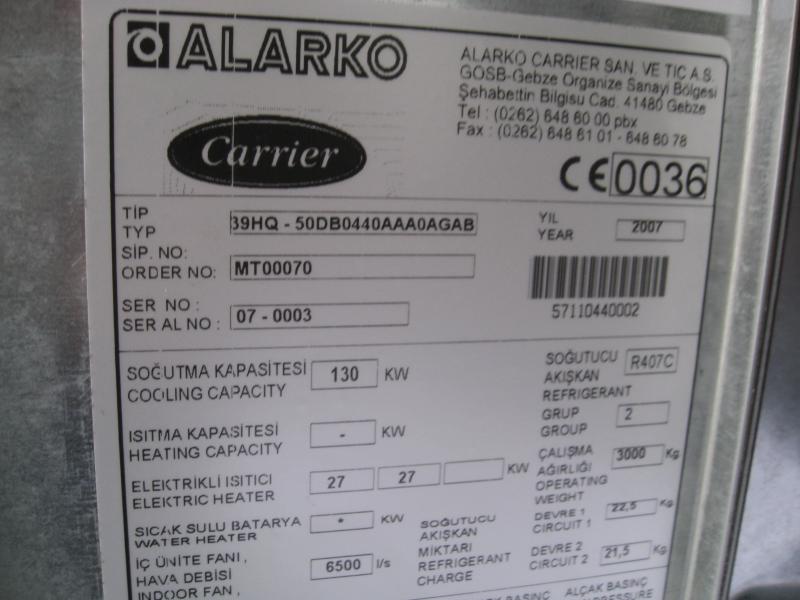

most are made abroad, shipped in and craned onto the roof.
Tesco use these
http://www.alarko-carrier.com.tr/English/AC_urun.asp?ID=ACU39
The long bit sometimes , houses heating elements

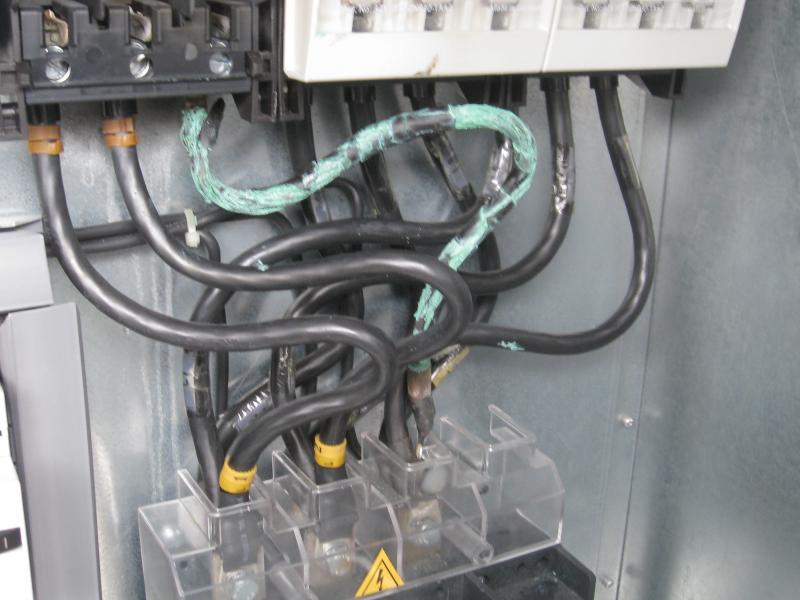

This one recently burnt out.

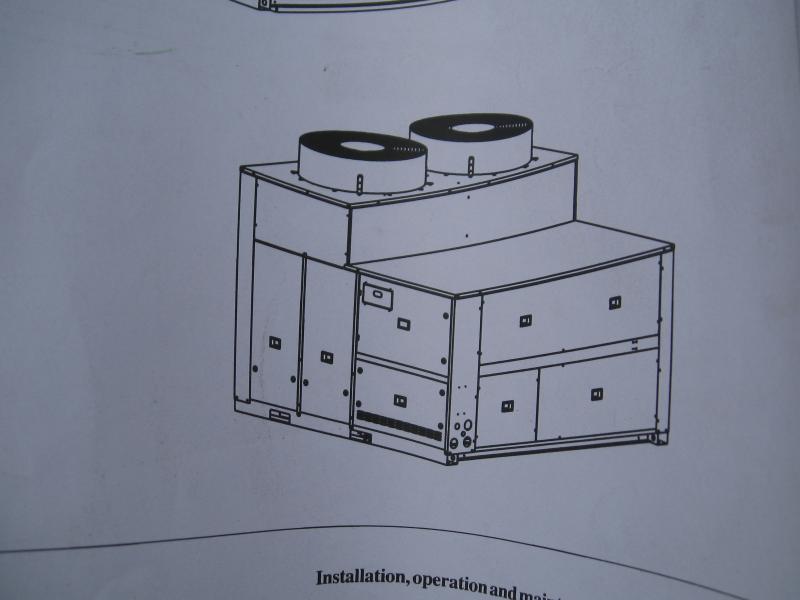

the round fans are cooling fans for the condenser coils.. they are open to the elements and do not introduce snow etc to the store..
those are chiller units and not air con as in the first photo..
the air con pictured was likely shipped in 3 pieces and put back together on site..
Tesco use Weatherite for most of their stores.. I know I used to build the things..
I very likely built the ones shown.. ( or at least wired it )
the small picture shows a version of the one the OP posted, the condenser coils shown at the far left ( where the round fans are on the roof. )
