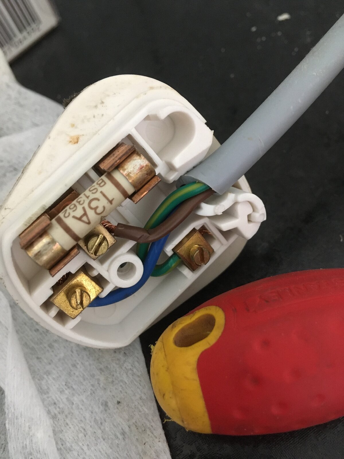

took this photo today replacing a washing machine!
It is wrongly wired and too much outer insulation has been removed so the cord grip does not grip.
It's not right - unless the same at the other end of the cable. :)
I’m not stupid I merely asked your thoughts.
Would it work faultlessly or cause problems? I’m a Plumber who knows how it should be wired.
More advanced than a brain surgeon! Xxxxx
Clearly wrong, however have seen many a central heating system using wrong colours, so would need to ring the earth to be sure not reversed other side as well.
With non RCD protected circuits it would work, and likely the user would be unaware of the error.
I’m not stupid I merely asked your thoughts. Would it work faultlessly or cause problems?
What EFLI said was correct. If it were wired in that same (incorrect) fashion at the WM end (which is incredibly unlikely), then it would work totally 'faultlessly', the only thing wrong being the colours used for the earth and neutral. If the WM end were wired conventionally (which it almost certainly would be) then it might appear to work 'faultlessly' if there were no RCD, but would cause the RCD to trip if there were one.

I found the same wiring in a plug attached to a fridge (In a factory electrical department). I needed a plug for my stereo and nicked the one off the fridge. The fridge worked just fine.
It was common to find this error until the law changed so plugs were fitted before you buy. However this has also resulted in children not being taught at school how to fit a plug, and the distance buying has resulted in items arriving in the UK with non UK plugs fitted.
30 years ago it was a regular thing to test earth pin to chassis, but as PAT testing came in, this seems to have faded, yes I have a PAT testing machine, well shared between my son and me, so I could use it, but at home I never bother, the error shown would trip a RCD and I have had RCD protection in my house since 1992, so in my house it simply could not happen.

About 1956 a washing machine "imported" from Germany didn't work and touching it gave the wife mild shocks.
The Earth wire in the lead was RED, and when fitting a plug the red should go to Live
"imported" in the back of an army truck after being liberated

Many years ago, before ‘elf and safety, there was a bit of kit wired like this at a company I worked for. It worked fine of course except when someone plugged it into a socket with L and N reversed. Everything else worked in this socket as well of course. The unfortunate technician involved grabbed the bit of kit while touching some (earthed) Dexion shelving with the other hand and got a really nasty belt.
These days that would be a very serious incident but then it was hushed up. The kit was required but the company were not interested in the reversed L/N socket saying it was not important. Around 1965 I recall.
