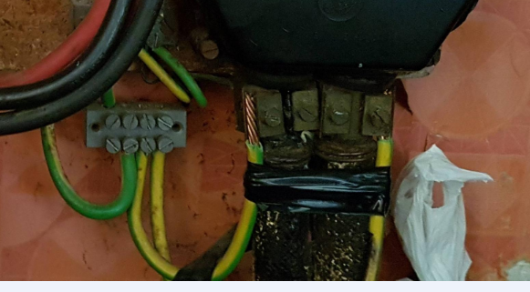

Edit: actually on closer inspection the earth is connected on both sides, it's just a trick of the angle.
Old post for posterity below
Did the electrician test your earth? According to the quoted photo, you have a problem with your earthing.
Call the electricity distribution company (ie dno, not your supplier) and tell them your earth is not properly connected and show them the photo. They will send someone out to replace it. It will be free of charge.

My pressing concern as mentioned earlier is that earthing arrangement on what looks like a looped supply
