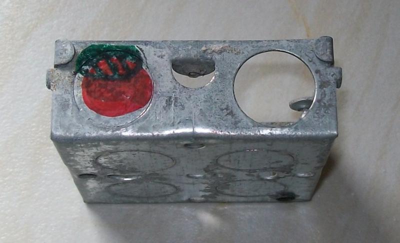

So the consensus, which I agree with, is that there is no problem at all terminating white oval so that it's end is in the conduit box.
Yet I've never seen that done, other than an occasional DIY job.
The norm seems to be to stop the conduit short of the box to allow the cables to be doglegged as needed to go through one of the holes - and the whole lot is plastered in.
Here is a box I've just taken out. In red I've marked the approximate area within a standard 20mm grommet, and in green I've marked the approximate area of a small white oval. You can see that there is a fairly small overlap, and except for the smallest of cables (eg phone) it's going to be very difficult in practice to pull new cables into that - even harder is the box is sunk a bit deeper and so the green area would be a bit higher up in the photo.
Not sure what the point of this discussion is.
Standard knockout boxes with 20 mm holes allow for 20 mm conduit and swa as well as regular twin and earth cables.
It is usual to knock a bit extra brickwork away near the cable entry to allow the cables to neatly enter. Sometimes it is a good idea to cut a small section out the back of the end of the conduit just to allow the cables to enter the box nicely. It is also a good idea to sink the conduit slightly into the brickwork to allow a decent covering of plaster, to avoid it cracking.
No need for oval cable to enter the box if a grommet is used. If the cable is installed when the conduit and box are installed, all should line up reasonably well and it's fairly likely you will be able to draw a replacement cable in (assuming there are not too many cables, and there are no dodgy joins in the conduit).
Oval conduit can be pushed into a 20 mm knockout, sometimes with a bit of modification. This practice is useful if you need to install the box and conduit, but will install the cable later.
On new builds, plasterers can plaster over capping better than oval conduit, if fixed directly to the blockwork.
It is always a good idea to use oval conduit or capping, particularly as you have a better chance of making a future repair or alteration without messing up the wall too much.

Which just about confirms what I have been saying.
The obvious function of using conduit (to allow future cable replacement) is something you pay lip service to. If you are only "fairly likely" to be able to replace a cable, then that's a fair admission that it's not guaranteed. If you look at the photo I posted last, and imagine how little of the green overlaps the red if the box is sunk just a few mm deeper, and it's not hard to imagine that there'll be ****-all area left - is that what you mean by "line up reasonably well" ? And of course, since you'll have (in many cases) the ends of the cable plastered in (depending how hard the plasterer pressed) ...
So like I say, it seems that consensus is that it's quite possible (and not hard in general) to guarantee no problems (by getting the conduit actually into the box), but that's not common practice.
