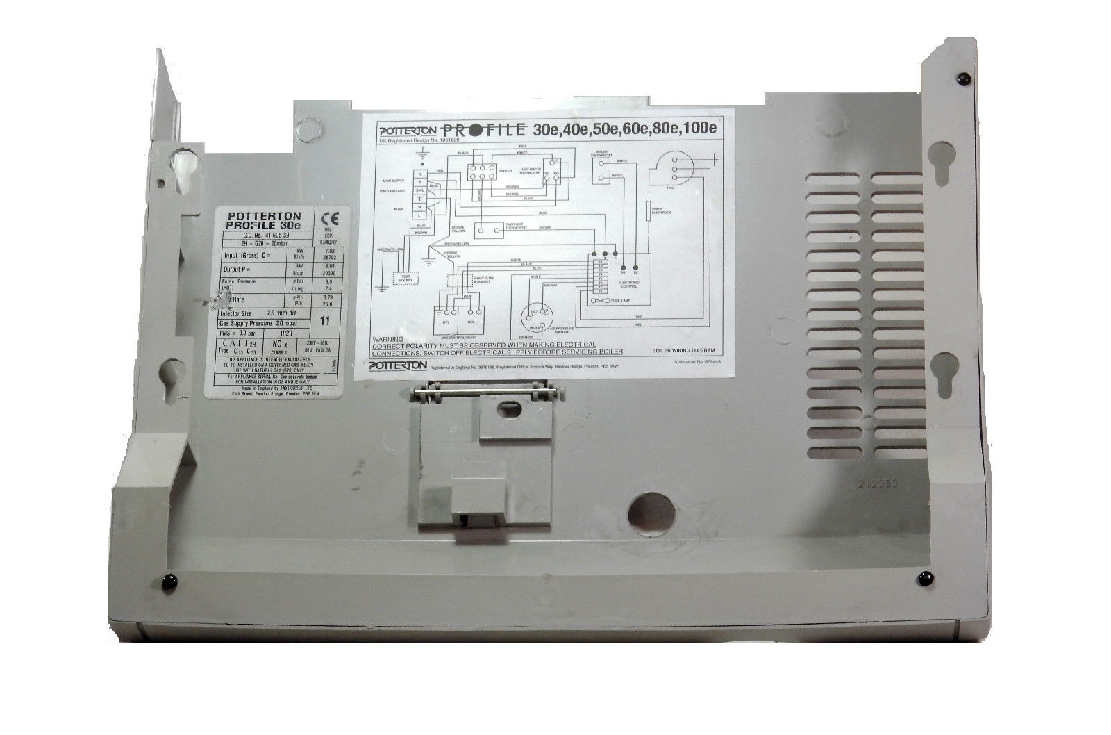

baggie79,inside the grey plastic controls cover (one screw to remove but dont force it off) there is a data badge stating the boilers kw/btu set up.
POTTERTON-PROFILE-PRIMA-NETAHEAT-PROFILE-30E-40E-50E-60E-CONTROL-COVER-907706-272867468105-3.JPG
Image is for a profile but its basically the same data badge for a prima.

Thanks that worked a treat. It is indeed an 80f

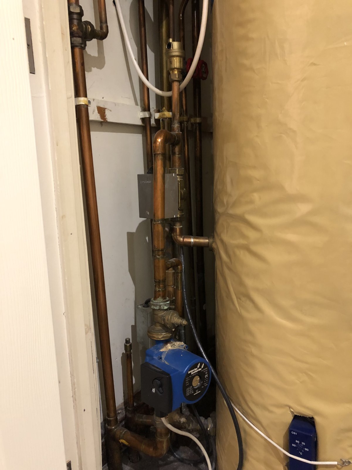

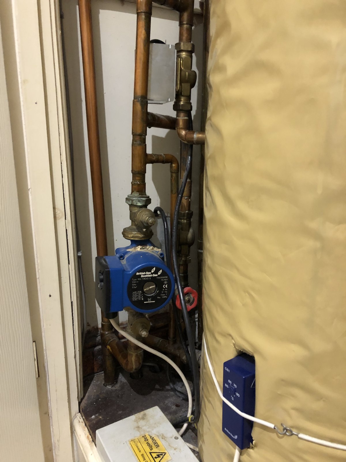

So, you can see the central heating pump at the bottom there. From that picture can you tell me if I have System bypass valve and if so how do I check if it’s fully open or automatic?

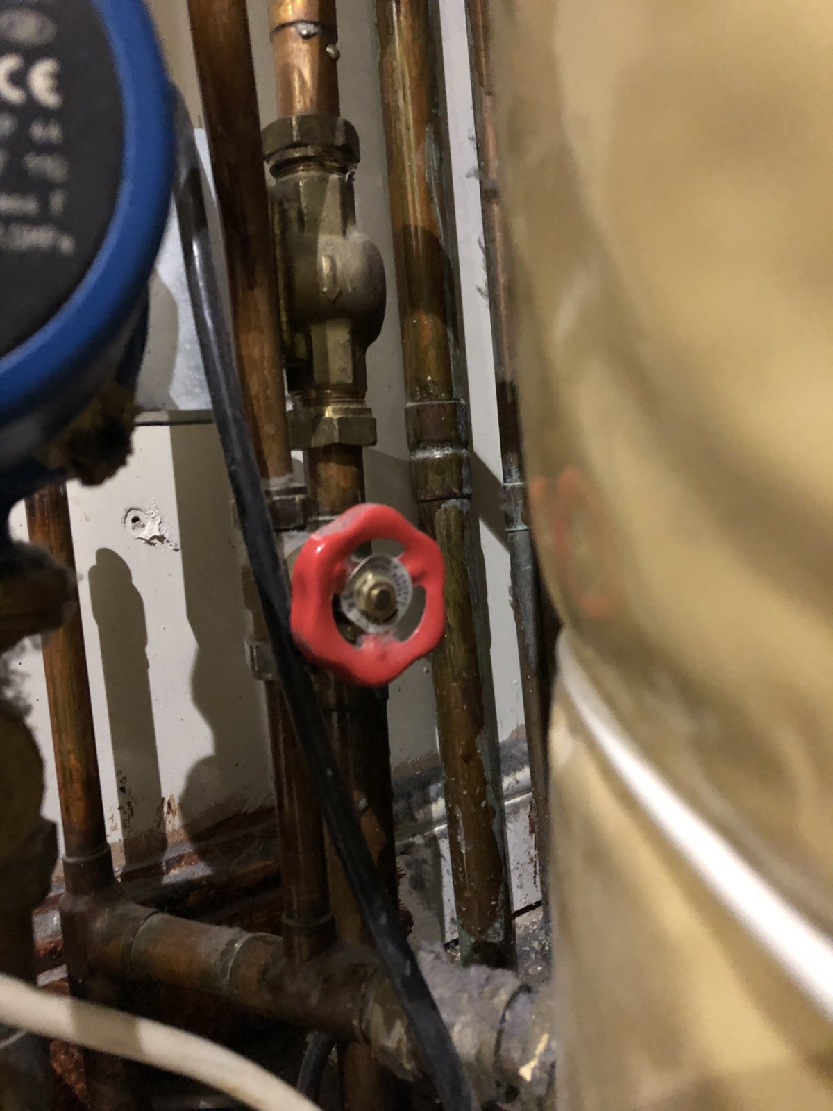

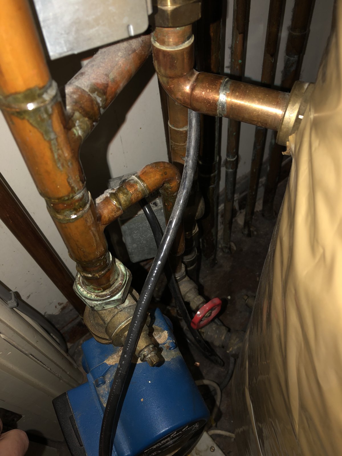

you have an S plan system and cant really tell from your pics but it does look like that valve at the bottom of your cylinder with the red head (gate valve) could be the by-pass cant really tell from your pic
Thank you so much.
Do either of these pics help at all?
