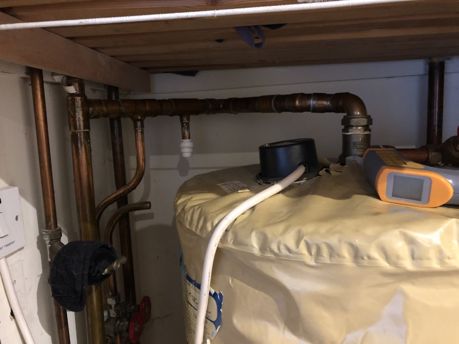

So, off the back of some previous comments around I may be losing heat somewhere. I’ve taken a picture which is attached, the pipe going into my hot water tank at the top there is around 40° Even though we haven’t got the hot water on the go at the boiler or from the taps. The pipe going into the central heating pump is at around 70°. Could I be losing heat to my hot water tank?
Picture of set up

Do the zone valves fully shut off to prevent let-by into the circuit not demanding heat.
Negligable heat is lost to the feed and vent pipework.
