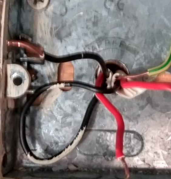

You missed where I asked why the black (N) is looped. I already thanked the respondent's for their input, I just asked one more question, but it's gotten lost in this argument.
If you mean that the black loops uncut out of one cable and continues into another (originally the same one, of course), then there is a red missing.

Because there will be a red and a black in each cable.
Is it not that the other end of the black has just been pushed into the hole?
Plus there should be three (or two) earth wires.

So where does the non-looped black come from?
It would seem to be a CPC which has been sleeved black - but it really doesn't look like that.
I wondered if it was that, too, but it looks too big wrt the black sleeving for it to be a cpc....
It does. However, if it's not a CPC what other possibilities are there?? The other half of the cable confirms that it does have red+black+CPC and, in any event, I would doubt that a black+black+red flat cable (seemingly, then, with no bare CPC) ever existed.
