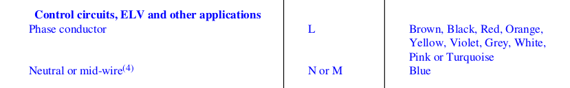

As a slightly related question, does anyone have any views of what colours should be used to identify the conductors of a ('floating') AC SELV circuit? Table 51 only offers colours for Line and Neutral of single-phase AC circuits - concepts which obviously do not exist in a 'floating' circuit?
... so, to be compliant with BS7671, should one use brown+blue (arbitrarily), brown+brown or what?
Any one or two of the 10 possibilities listed here, surely? So brown & brown, brown & black, red & yellow, pink & white, orange & turqoise........ But not blue (assuming you're talking about a simple two-wire floating circuit).
Yes, I forgot that bit. I have to say that it would seem a bit odd to use two different colours, since that would tend to imply a difference between the two conductors which doesn't exist, electrically speaking.
