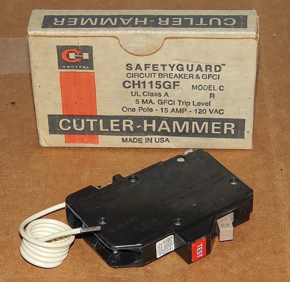

I have this nice. clean white on a breaker, but of course it's our neutral.......
dscn3833-jpg.91560
Interesting that Wylex RCBOs appear to have a white earth wire, should that be sleeved with green/yellow inside the consumer unit?
That's a functional earth, not a protective conductor. If it was, it would have to be able to carry fault current.
Indeed. In the presence of an appropriate fault, it obviously could end up carrying the consequent fault current - but, as you say, since it is not there as a CPC, it is not required "to be able to carry" that current (i.e. it is 'allowed' to melt!).
Kind Regards, John
The basic standard for identification of conductors, IEC 60445:2010, doesn't specify or recommend, a colour for functional earthing or bonding conductors.
Seen loads of cream FE's on telecoms systems...
PBC. Are those breakers current stock?
They look similar to our previous gen breakers going back as far as the mid sixties.
In one of my IEC committees we discussed the possibility of specifying a colour for FE/FB conductors, but couldn't agree - in some countries, white is specified, in others cream, but the list of available colours (IEC 60757 IIRC) doesn't define 'cream'. Should we use Tesco single cream, or organic Devon clotted cream? Nearly white, or nearly yellow?
