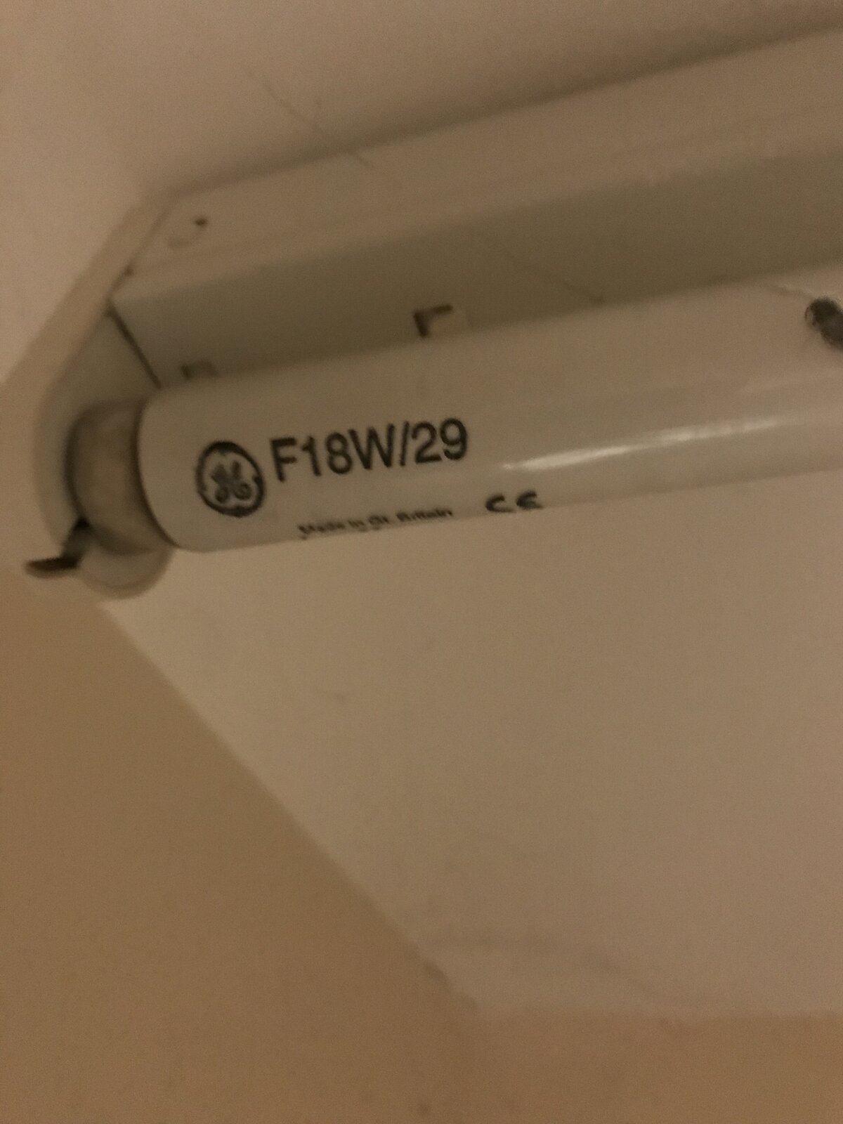

Could I pls have some recommendations as to what I can replace the unit which houses these tube lights with a long life LED one instead?
I would like to get an idea of product costing before I buy it and get a professional to install it.
Thanks.

How would I know as a lay person whether there tube has gone or if it’s the starter (if I don’t have a replacement tube to hand to try)?
The reason I’m considering replacing the tube holder is because I presume the tube has gone and I might get an electrician in anyway for some other minor works. I own a dental practice and we have a old tube in the disabled and only bathroom and when that goes it’s going to be a headache for me to change it quickly.
I’d rather have a LED one that lasts 5-10 years since the light is almost always left on during the day consuming 70-100 watts v 15-25 watts. And we have several of these in the building with no backup light in critical areas.

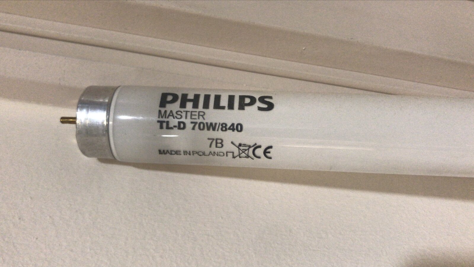

What does the /840 represent? Can someone pls recommend some appropriate lengths to match?

So 70 watt will be 6 foot tube, the LED replacement is one expensive around £30 and two likely only 40 watt with a 4400 lumen output, where with a wire wound ballast the fluorescent is around 6000 lumen output and an electronic ballast around 6800 lumen output, so if you need the lumen output then better changing the whole fitting. Even if you don't need the output still likely two LED fittings will replace the single fluorescent, so you really need to look at room or area and decide what lighting to use.
840 is cool white, 4000K.

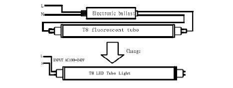

The electronic ballast is far better than the wire wound, and the wire wound was discontinued however the electronic would not work with early LED replacements, I know my son fitted a LED in an 18 watt electronic ballast lamp and it works, without removing the ballast which was a special as it included battery so light auto turns on with power failure, otherwise he would have removed the ballast.

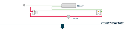

In theroy this
works, however the non power end of the LED is a short circuit, so really the two ends should be wired in series, so it does not matter which way around the tube is put in. Other wise it will be a short circuit which is not what is wanted.
So this 1726982438672.png becomes this
both for magnetic and electronic, so does not matter which way around the tube is inserted. But with wire wound the ballast can be left in place if you want, although less efficient if you do, and the starter is swapped for a fuse which normally comes with the LED tube, and is shaped the same as the old starter.
If the tube is at end of life but starter is good, the starter will repeatdly try and start it and it will flash in a very annoying way, this will put a lot of extra wear on the starter which will soon cause it to fail too.
If the starter is bad, it will keep the filaments at the end of the tube glowing without trying to start it (this puts a lot of wear on the filaments and blackends the end of the tube, and sometimes melts parts starter sockets or plastic parts around the ends of the tubes, you can often cause it to start by removing the starter if the tube is still able to strike as this mimics what the contacts in the starter to. Putting it back in will result in it returning to the previous condition but when the light is switched off and on again, it'll do nothing at all without a starter.
It is normal to change both together, they are probably a similar age and if one isn't bad, it'll have been age prematurly by the one that is. (which will then soon fail, rinse and repeat....) Or course if its been left a while, both may be bad.
