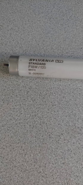

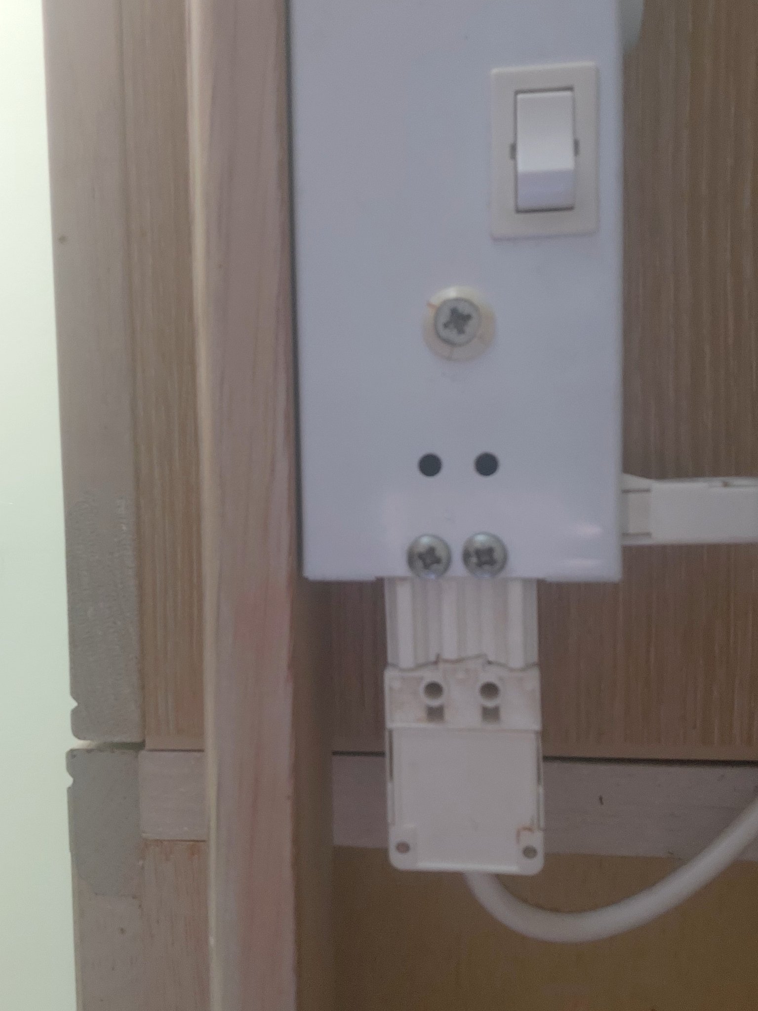

Flourescent tube for kitchen lighting.
You bought a led tube. Has Loads of LED lights inside. That won't work although you can buy bulbs and some bits to convert light but not worth it.
You need the older gas filled tube that's started to be discontinued.

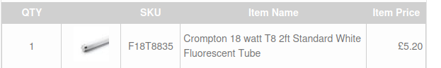

Is it just the old style £4 ISH fluoresce tube?
2 foot tube?
Much appreciate all the replies to this, thanks again.
That is the fitting fitting, yep £4 two feet flourescent tube. Looks like I was trying to fit an LED into a fitting designed for flourescent.
From memory I did a successful replacement about three or four years ago. I'll see if I can dig out an old T8? online. Not mission critical, three out of the four tubes are working.

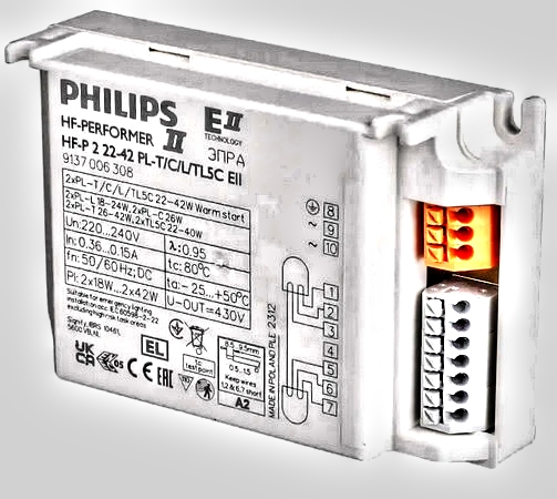

But the problem here is the electronic transformer often wired like this
with twin tubes, note terminals 3 and 5, this will not allow LED replacements. There is no option but to remove the electronic ballast and rewire.

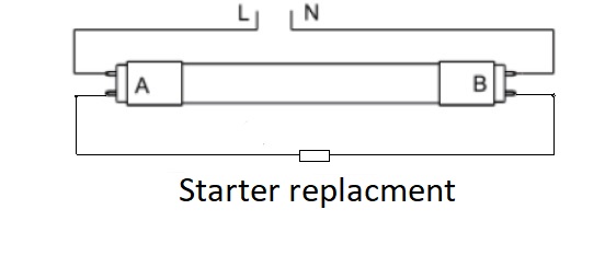

The led tubes are backwards compatable to be fitted by average joe.
Just change the starter inside for the supplied one (fuse)
Fit the led tube
Fit the led tube
Not quite, it depends on the ballast used. With a single tube and a magnetic ballast yes, easy to simple swap. However once you go to electronic ballast and twin tubes not so easy. Also even with a magnetic ballast, the ballast acts as a resistance, so typically a 58 watt fluorescent is replaced with a 24 watt LED, and in lumen that often means 5200 - 5600 lumen down to 2400 lumen, so no where near as much light.
