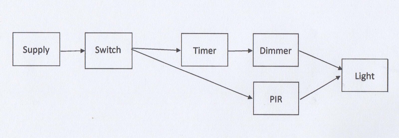

I'd like to be able to schedule my outdoor lights to come for a few hours each evening but at a dimmed output.
I'd like the lights to be on fully if the PIR is activated, at any time in the night.
Could I wire a smart wifi switch in series with / feeding a dimmer and have a PIR in parallel to both ?
Would that achieve what I want and would be acceptable to do ?

If done properly, then yes, but the supply point of both systems, would need to be one single point of isolation.

Do not try to obtain any "Light-Design" with "features" built-in.
Obtain the "Light-Design" that you want,
the "features" that you want
and
wire them up - together.
Wiring in accord with the following Block Diagram should suit your "needs".

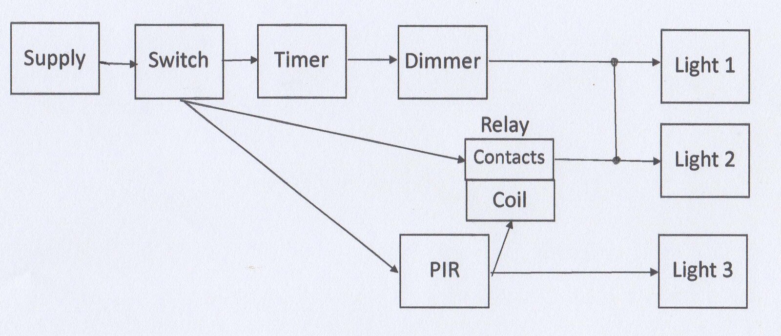

Thinking about this some more - I have a follow up question.
I have three external lights - two at the front path and one at the corner of the house.
Is it possible to have only the 2 path lights come on with the timer but all three come on if the PIR is activated ?
How can I keep the corner light off from the timer circuit but on with the PIR circuit?
It is possible.
However, you will need to add a RELAY - somewhere.
A "Block Diagram" of this is shown below.
