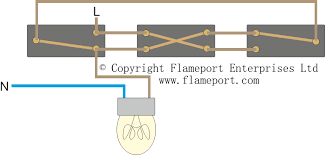

Can you draw a diagram of the wiring of the front room circuit before and after your changes?
I suspect you've just connected the new switch in parallel with the old one, you actually need an intermediate switch (4 terminals) in one of the positions. Google intermediate switch for a diagram.

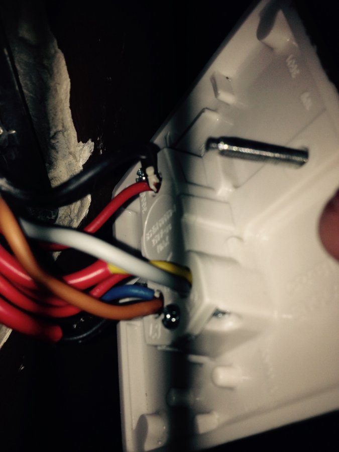

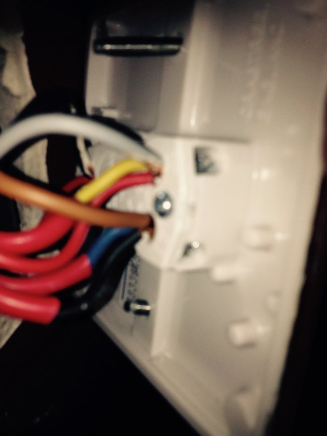

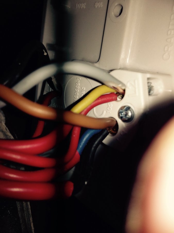

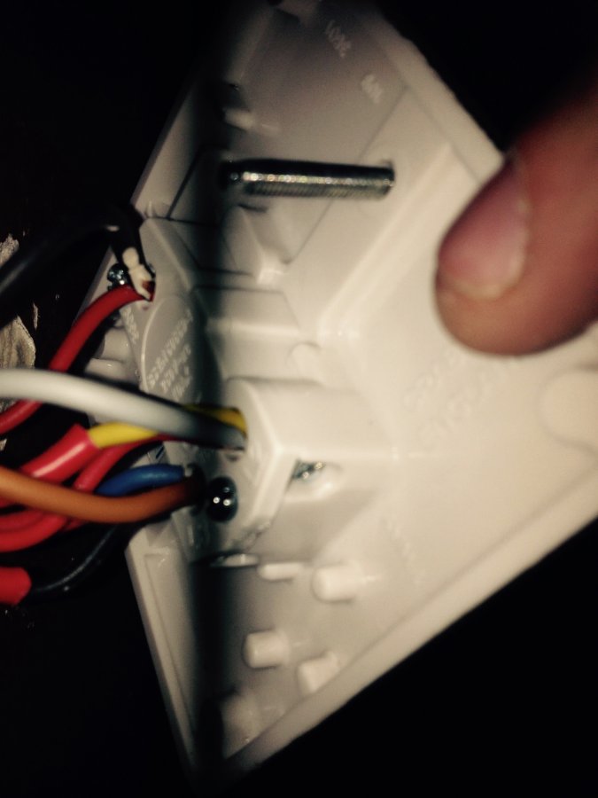

image.jpg image.jpg image.jpg Alright guys I bought some 3 and core. Still having trouble wiring up. The double I.e. The right switch controlling upstairs works fine now. The trouble is with the one on the left of the double, that's one of three downstairs controlling the front room light. Here is the switch I'm spuring off to the double.....
Since wiring in, the front room light will now not turn on from any switch
Why are there three wires in the terminals?
To make a one way switch 2 way, the two wires attached to the switch go in L1 and L2 (or L2 and L3), along with two wires from the new 3 core to the new 2nd switch.
Then the third wire in the 3 core goes to common.
At the new switch, the colours in L1 and L2 of what was the one way switch go to L1 and L2. The colour in common goes to the common terminal
I think I've just got it: Are you wanting to make the front room light a three way?
In which case you need to use an intermediate switch and wire it differently.
Apologies: JD got there ages before me....

If this is the case, you need to find the single front room light switch with just a 3 core in. Run a new length of 3 core from here to the position you want to add the switch to.
The front room light switch with the two 3 cores you fit an intermediate switch to (see Wiki).
A 2G 2W switch goes in place of the landing switch, with the existing wires fitted to landing side and the new 3 core wired to the front room side.
Sorry I haven't explained myself properly.
A single switch is on the wall opposite to this.
This switch is a single on the wall near the stairs.
I want to wire in a double switch next to the stairs;
I have wired the upstairs lighting to the double switch fine.
BUT connecting the other switch on the double to the single switch (along the wall) in the front room (like the previous two) is proving troublesome for me.
The brown and grey wired in as shown (along with black, are the new 3 core and earth connecting to the double)
So you have "piggy-backed" off the connections that are already there with the new 3 core?
IE added to the red/yellow and blue/black that were there when you opened the switch?
This will not work.
Including the switch you want to add, how many switches will control the front room light?
At this point, your simplest fix is to replace the single switch "along the wall" with an "intermeidate" switch.
Buy one of those, and then post a clear photo of the wiring of the existing single switch at that position.
Then wait for someone to tell you what to connect where. You may also need some terminal blocks.
