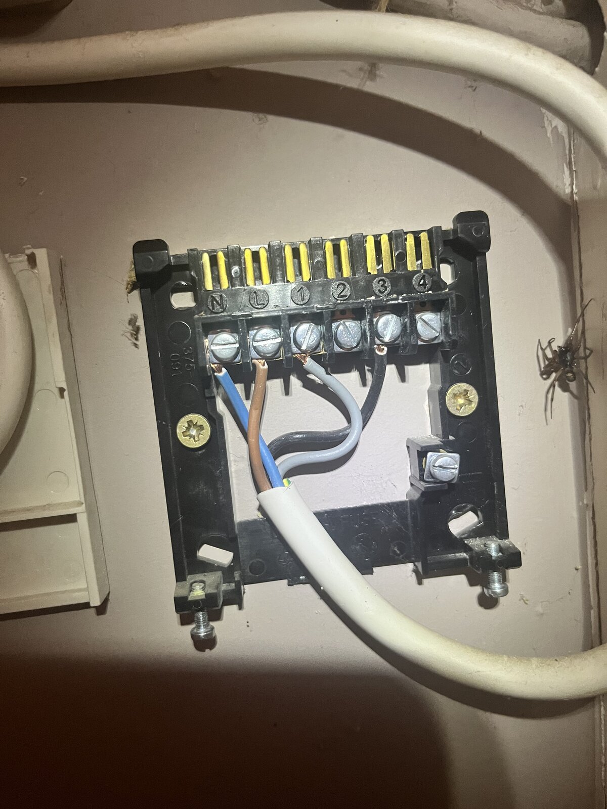

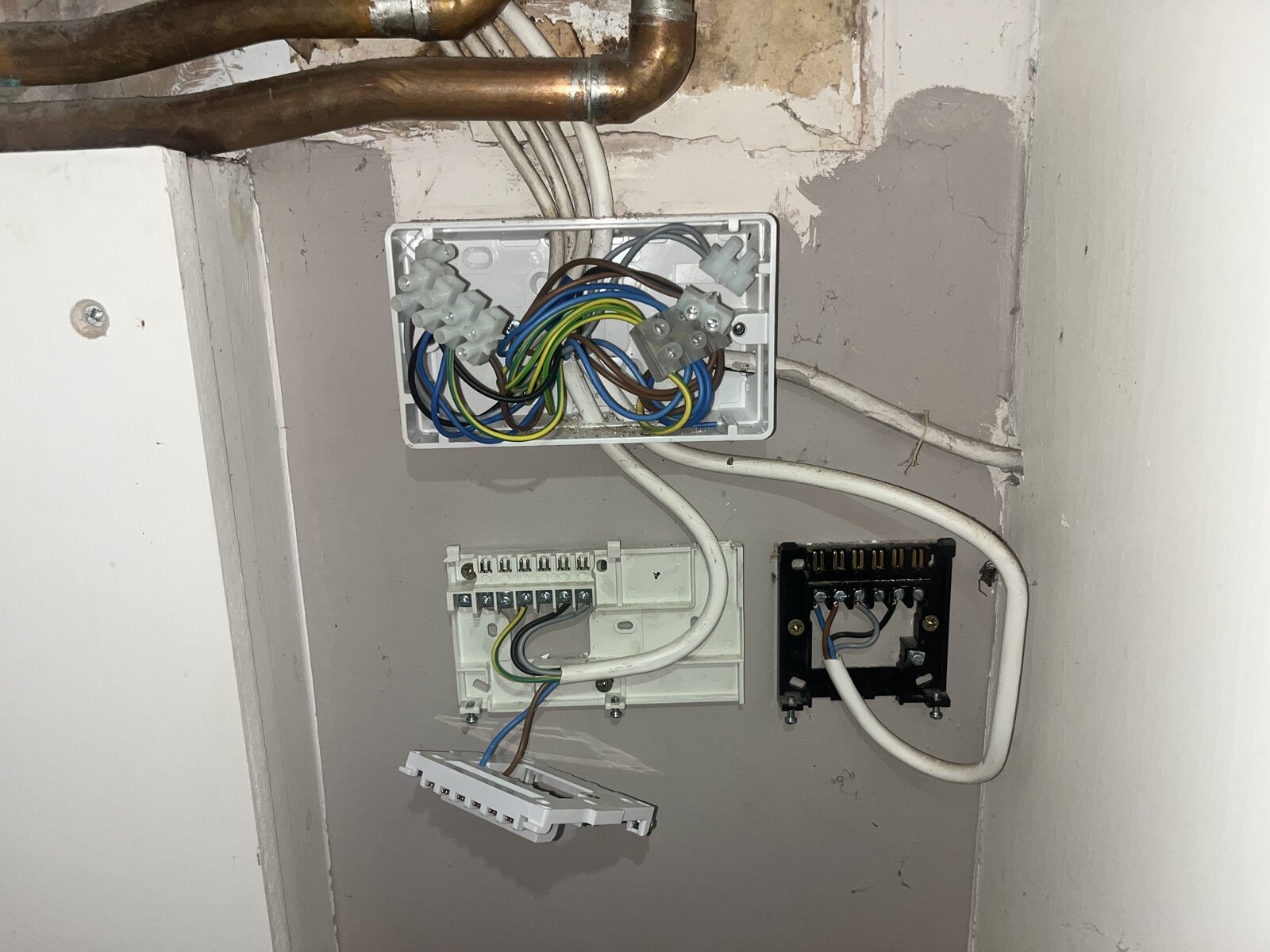

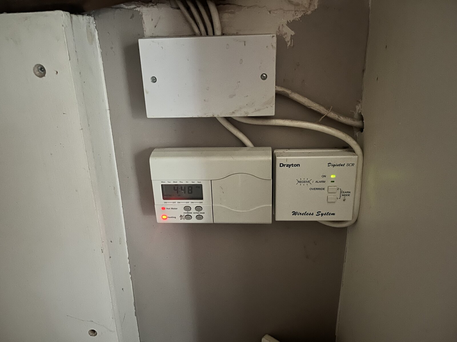

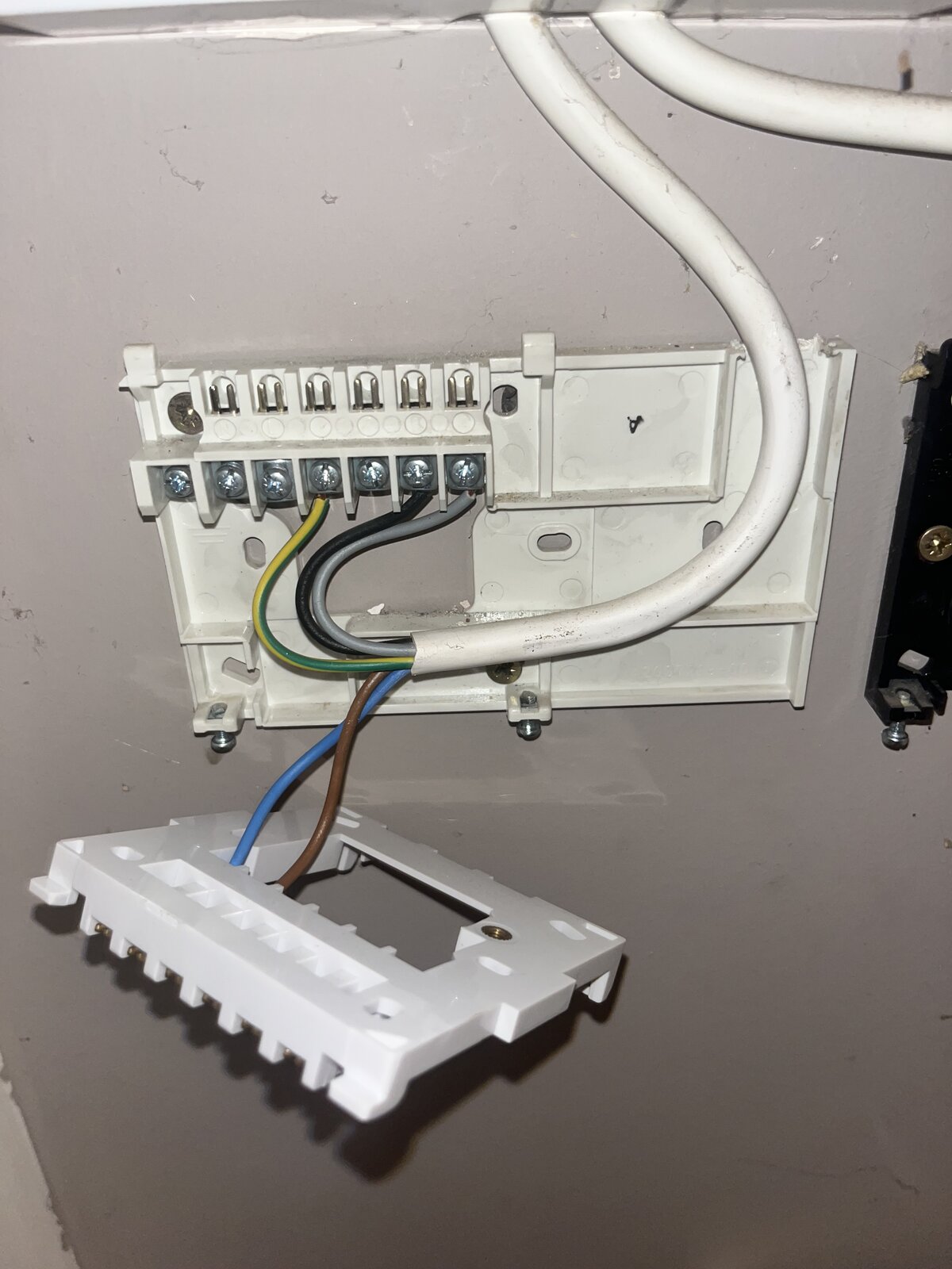

Hi all, looking for some advice. Trying to change over the existing digistate scr to hive.
Advice on which wires to move over would be appreciated
This is for a duel system.
Transfer all the wires in programmer to Hive and sleeve the green/yellow if live. The SCR can be decommissioned and a bridge wire placed across where the grey and black go in the wiring center.
Thanks. Just to clarify it’s the grey and black wire from the SCR that needs to be bridged within the wiring centre?
