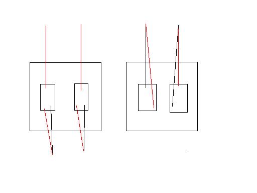

wiring switch
right, put 6 back the way it was and take out the link between the com of 6 and 7.. what happens then..
right, loop out
blck in c red is in l2 of 6
6 and 7 do nothing
3 and 5 turns hallway and kitchen on off together 2 way
4 does nothing
great, so we now have the hallway sorted..
remind me again what switches 4, 6 and 7 are supposed to do? the kitchen main light 2 way and the under cupboard lights one way?
take the red out on L1 on switch 7 and put in in the com..
what happens when you flip switch 7 then?
hallway sorted cheers
4 and 7 should work kitchen spots both 2 way, 6 does under cupboards 1 way.
took red out l1 of 7 and put in c
4 and 7 do nothing
6 works cupboard lights but only when 5 is on
huh? 5 shouldn't have anything to do with the kitchen now...
