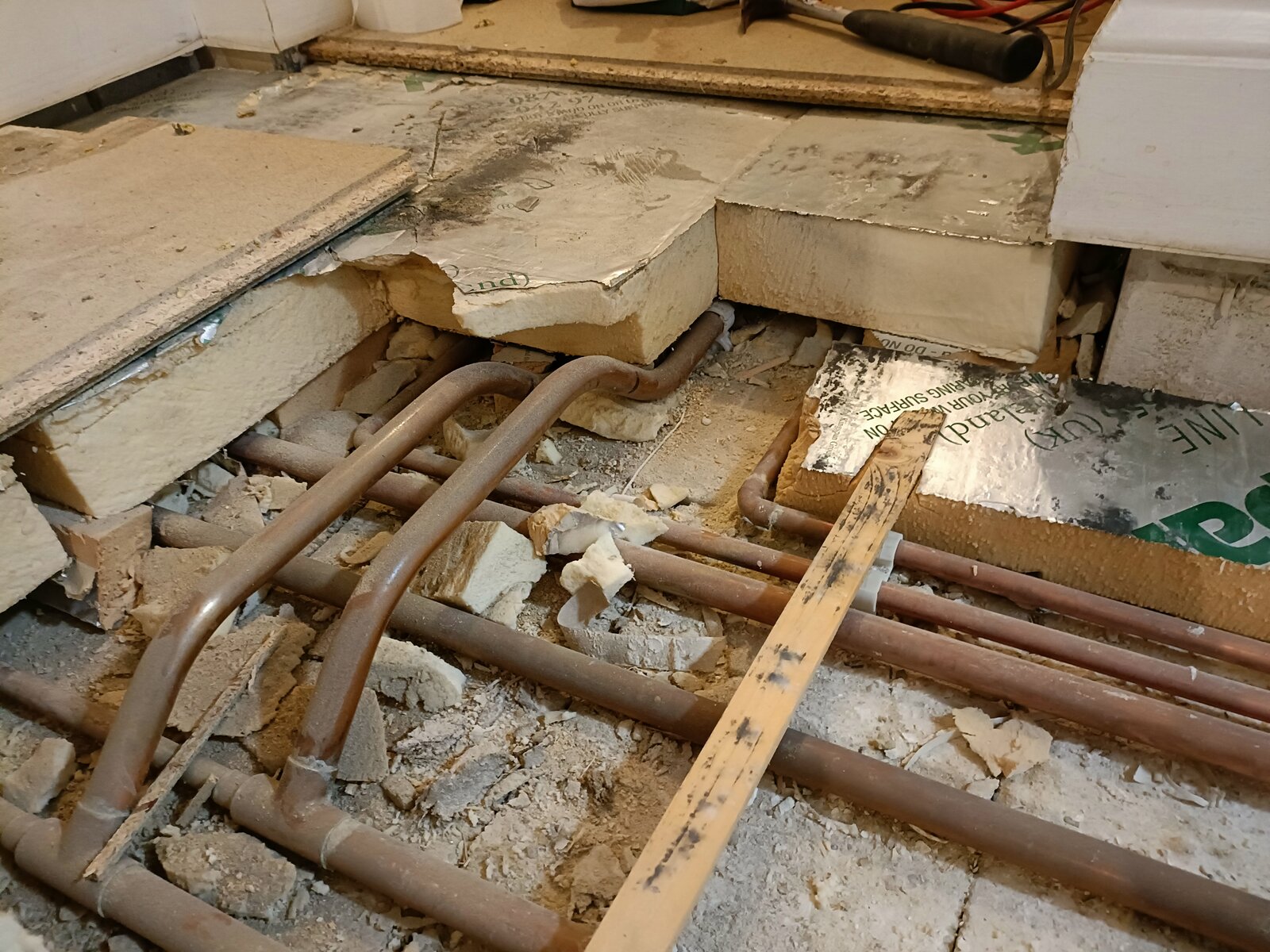

Bit of a spanner in the works, I've taken the floor up and was met with 80mm of rigid insulation panel (Kingspan), so it's a floating floor, no wonder it creaks so much.
The main surprise is that under the kingspan are heating pipes, and the void for them is made by putting 50mm Kingspan on either side of each pipe, putting a slim piece of wood across them, then putting an upper piece of Kingspan on top. Photo attached.
Under the pipes there are concrete planks supported by a steel I-beam. So looks like the house is more of a chonker than I thought. The floor thickness is 35cm.
So, challenges:
1. What can be done to firm up the floor panels and stop them creaking?
2. Are cables in this kind of ceiling likely to be in conduits only? Any issue with adding cabling without adding the conduit?
