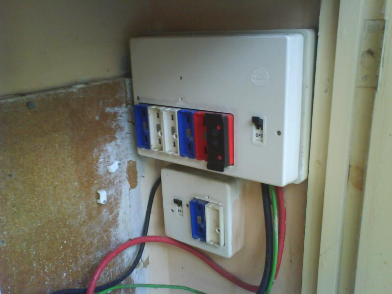

For a twin-core 1.5mm² sheathed cable running under galvanised capping in the plaster, the Iz looks like it will be somewhere around the 15A present fuse rating.
That would be Reference Method 3, which gives a capacity for 1.5mm² of 20A.
But as you've got BS 3036 fuses, you need to adjust that by a factor of 0.725, so it's capacity becomes 14.5A, which is less than 15. Not a lot, but less is less.
Or, turned on its head, for a 15A BS 3036 you need a cable with a rating of 15/0.725, i.e. 20.68A, which is more than 20. Not a lot, but more is more.
Given that you're going to have to find a way to add RCD protection, go with the idea of replacing the CU, do away with the rewirable fuses, stick with 2.5mm² for 32A ring finals or 20/25A radials.

Thanks BAS, it looks like the existing wiring/CU would not meet current regulations but is probably not exactly dangerous.
With a new CU, what rating factor should I use instead of the 0.725 for the old semi-enclosed fuses?
The top fuse-box has 5 of the 6 fuses used (none, lighting, lighting, immersion, sockets, cooker). The bottom fuse box is not connected. (I took the fuse covers off for the pictures.)
Should I use conduit or just clip the new cable into the channels and plaster over it?
If I put in a new ring in twin-core 2.5mm² running in plaster and a new CU, what rating would that have and what circuit breaker should I use, please? I'm planning 5 twin-socket outlets. Do I need to run a separate earth?
27A and 32A.
