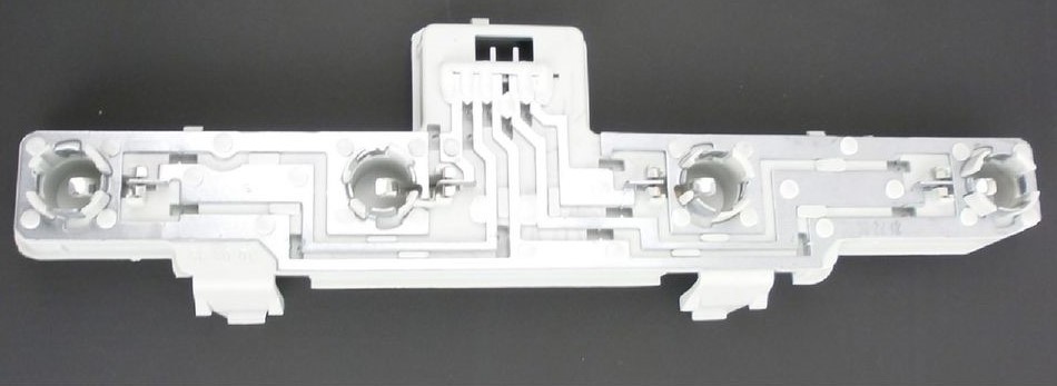

It would depend on whether it's solid backplate carrying the voltage, or wired point to point - and whether theres any corrosion or something stopping a good contact.
OP, does the holder look like this?...
All four lamps are single filament.

The Zafira B uses a single filament bulb for the stop and tail lamp. It's then pulse width modulated for the tail light, hence the 3v reading that the meter thinks it can see, you'd need an oscilloscope to check it properly!!
Ouch, this one just went way over my head. Would that imply that the 13v reading shows the pulse width modulating wasn't working on the duff side then.
