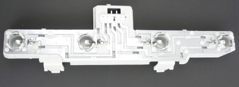

Have you checked for loose plugs in that rear box? I take it it's one of these?
OP, does the holder look like this?...
Yup that's the one
