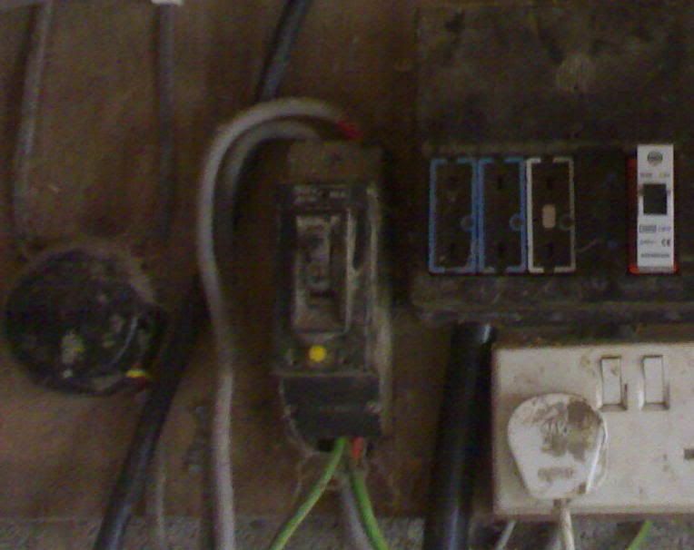

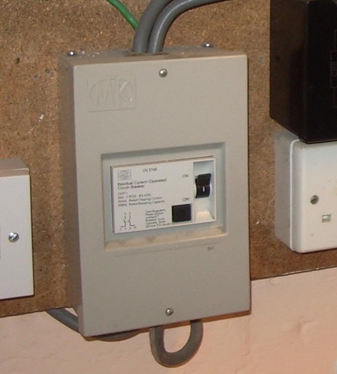

Just had a look through my extensive photo achive, and you're in luck!
Voltage operated ELCB (Note the earths connected to it)
Current operated
Ah,
That voltage ELCB pic is exactly what I will be replacing next week with a 100ma RCD in a TT installation.
The interesting thing is that when the kitchen was done in 2005, the installers spent ages digging to fit an earth rod and get an acceptable Ze, then left this protecting the new lighting and fixed equipment circuits on the new split load CU they installed (sockets and jacuzzi on a 30ma RCD).
They also completed a green NICEIC certificate stating that there was a 100ma 100A RCD, and quoted a trip time of 21ms.
